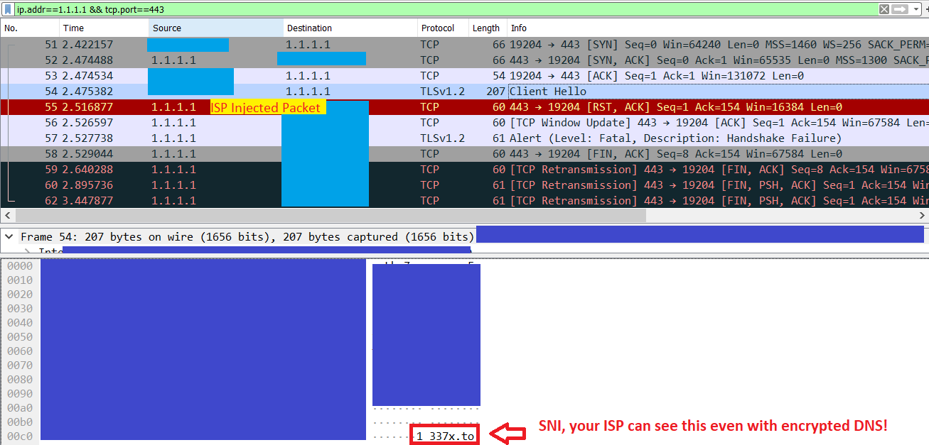

ISP middleboxes seem to return RST Packets right after TLS ClientHello (ClientHello contains the SNI). There is no need to continue with the TLS handshake to check blocking because of this.
Just sending ClientHello without anything else will help reduce CPU load a ton and help query a lot more domains quicker.
Unfortunately, Python doesn't have any modules which I can use to just send ClientHello without doing full handshake. I'm trying to make my own with scapy to create a TCP Connection, send TLS ClientHello packet, if RST is returned the site is blocked. If anyone has more knowledge in this than I do please do tell.

WireShark output:
