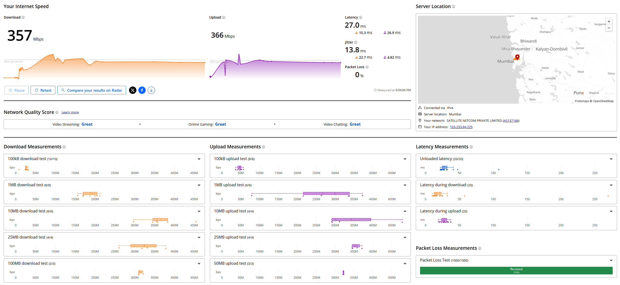

I am not going to do speedtest.net, as I find it false & meaningless. If you want to do your own traceroute & ping tests, then you can use my probe at RIPE Atlas - RIPE Network Coordination Centre
Let me know what else you'd like to know.
