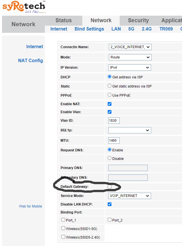

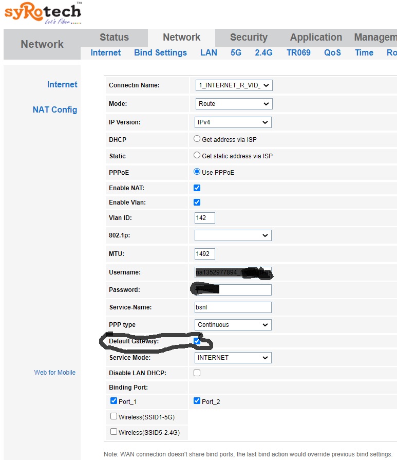

My ONU saves settings in the Network section only temporarily.
I have to manually add static routes, and configure settings (both for VOIP), whenever the ONU reboots. This is very frustrating.
The LCO is a noob and says if there would be an issue from their end, it would reset the entire ONU settings, and not just the Internet and VOIP profiles.
What is the purpose of Port Binding? It seems to make no difference to my connection, except that i need to disable it on the WLAN ports for VOIP apps to function on my phone. And, like other settings under Network, it too gets enabled for all ports post reboot.

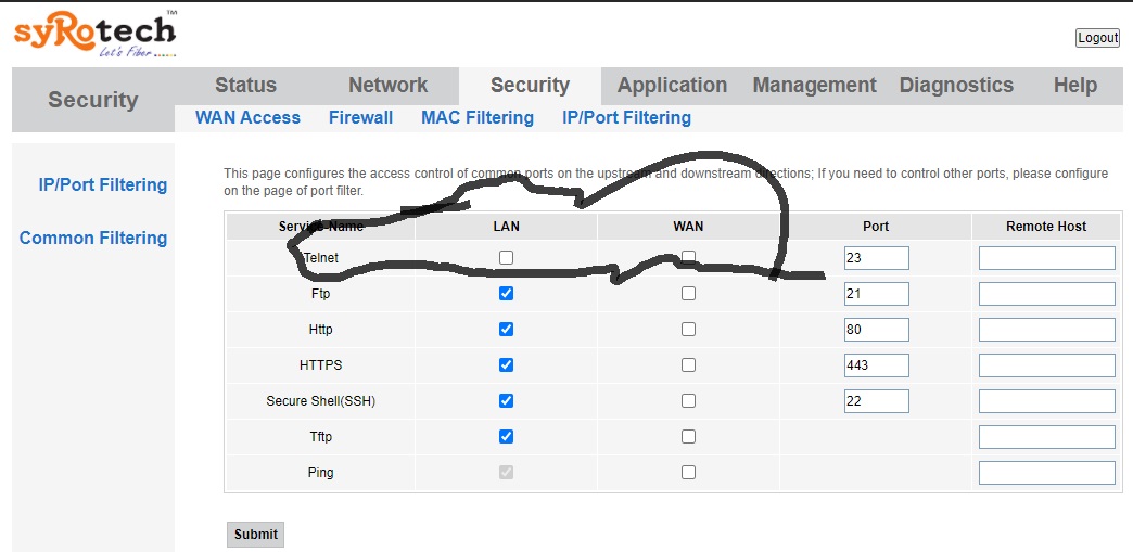

In addition, I'm unable to enable Telnet to do any form of troubleshooting. The moment I hit Submit, the checkboxes simply get unticked themself.

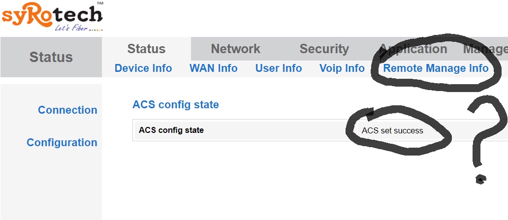

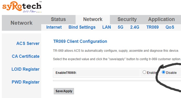

A strange thing that i noticed is that it shows ACS set success in the ACS section after every reboot, even though I've disabled TR069. And the TR069 disabled state persists after reboot.

Port binding is a way of making a port exclusive to a particular profile like Internet or VOIP.

I tried a couple of things today. Managed to telnet into the ONU, only to discover that it had a very limited set of commands. I was following the process mentioned by @Nikhil Sharma in:
I then FTP-ed into the ONU and deleted the lastgood.xml_bak files from both /var/config and /etc/config. Then, to check if settings persist, i disconnected the PON input and then rebooted the ONU. The settings persisted. And, somewhat to my surprise, the lastgood.xml_bak files were back too! However, the moment i plugged in the PON, the settings were back to square one. This makes me feel that that file is not the culprit. It must have something to do with the OLT.
