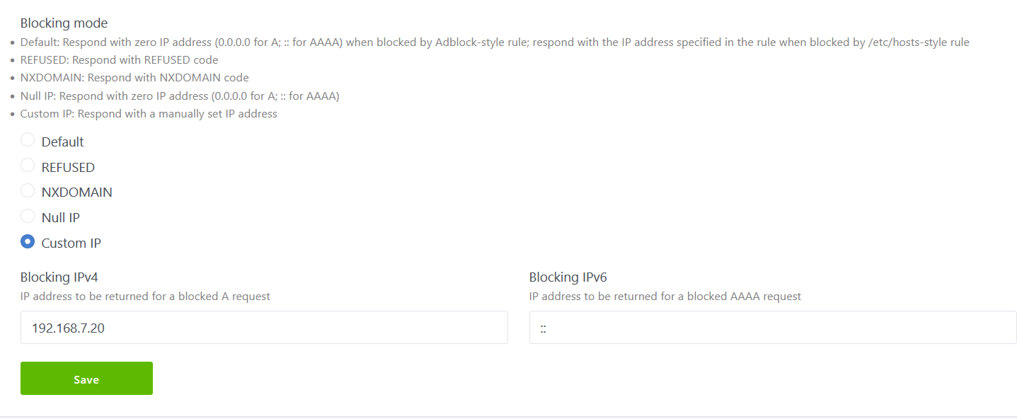

@venkatachar
you need to set ur pi ip as custom ip under Settings>DNS Settings in AdGuard Home
