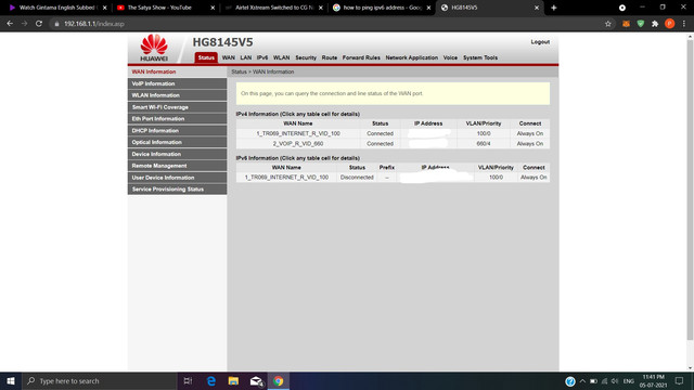

How to enable ipv6 in this huwaei router please tell
Those settings are for lan ipv6 not wan
Steps to configure IPV6 on Huawei router
1. Go to WAN Settings page and delete current connection with vlan 100 (copy username if you do not know it)
2. Click on New and do the settings as in Screenshot attached enter your pppoe username (copy from old wan configuration) and password (get it from bill your relationship no is password). Also select ssid no of you wifi I could not do it as I have disabled wifi
Save configurations
Screenshot WAN Setting
i did the same but in ipv6 its showing disconnected so airtel has no support for ipv6 as yet
