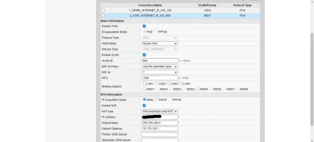

I just change some settings told by sloj in his post-https://broadband.forum/t/203538/
1. Voice to voice internet (on Huawei modem it is disabled so I use to inspect element on the browser and enable via edit attribute) Screenshot (14).webp
2. Enable NAT
3. Created Static route

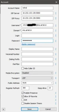

4. Setup the Microsip like you guys did see in the attachment

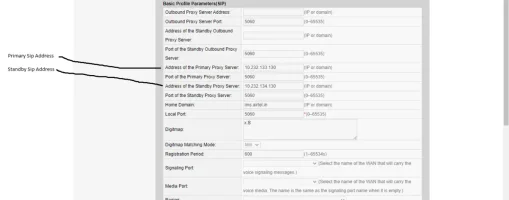

before that I use Primary SIP address, So I was able to receive calls but can't call anyone, and so figure it out accidentally when I put the Standby proxy server address in the Proxy box of microsip.
