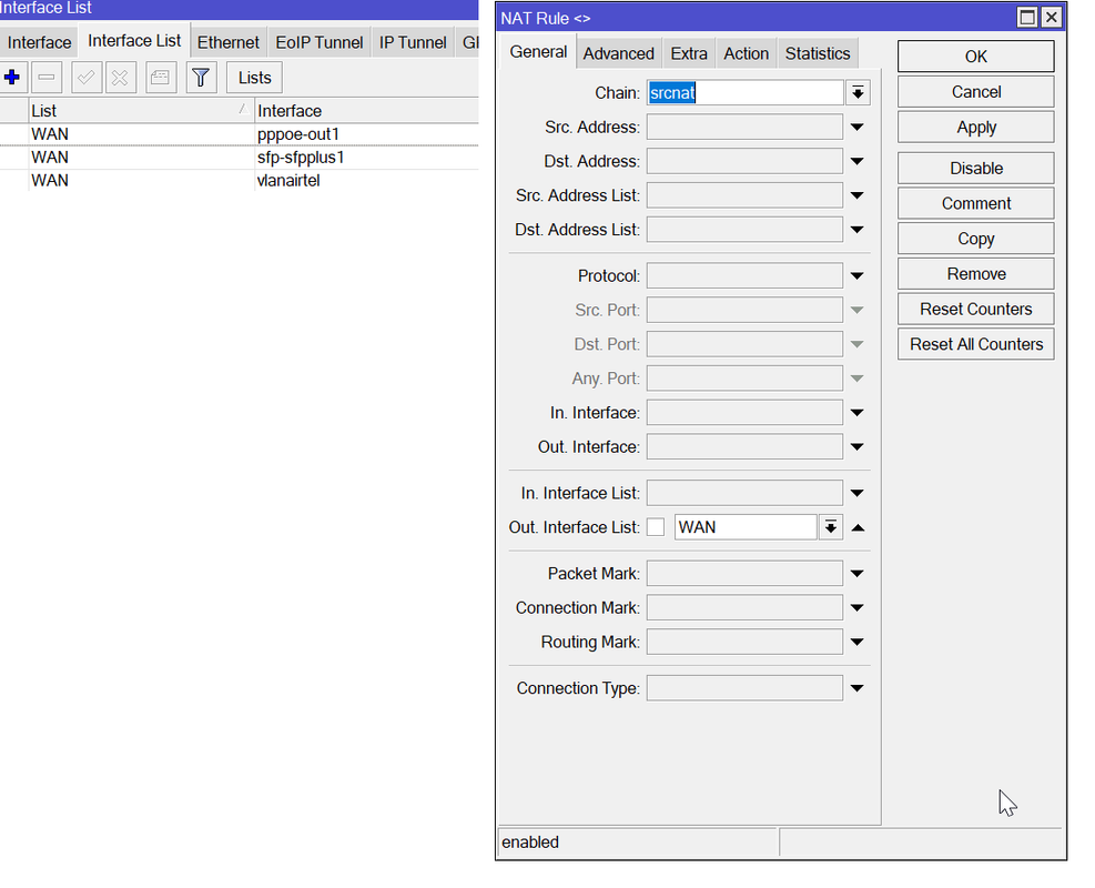

Regarding my nat firewall, i usually create a interface list and all all the wan related interfaces in that. Then in NAT, created single masquerade rule for the interface list like below,

My srcnat/masq rules are working, I went with your approach and used an interface list attached to WAN.

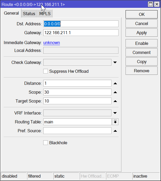

On the RB5009, when I try to add a default route, it fails as it cannot reach the gateway 182.70.116.1
See:
I just need to see the default route settings you used for static IP on ROS.
mine is same as yours, but as i said, i no longer use static ip and disabled it. Here is the screenshot from that.
Try checking firewall rules, probably disable complete firewall for a moment and test.
@Strykar i'm not sure whether it relevant, but the static ip address config should be similar to the one you defined for SFP address.. ie, IP address is 182.70.176.x/24 and network is 182.70.116.0
Yea I need to see a working configuration's Status tab of the route window you posted above.
Disabling all firewall rules did not fix it.
@rajil.s Mind sharing your route settings, at this point the OS doesn't matter, I just wanna see what's working for others?
@hariselio That was it, thank you very much mate! It needs the network via CIDR so the static_IP/24 was the address required! Route works and so does srcnat and masq! Woo hoo, ISP optics replaced! Thank you all in this thread 🙏
