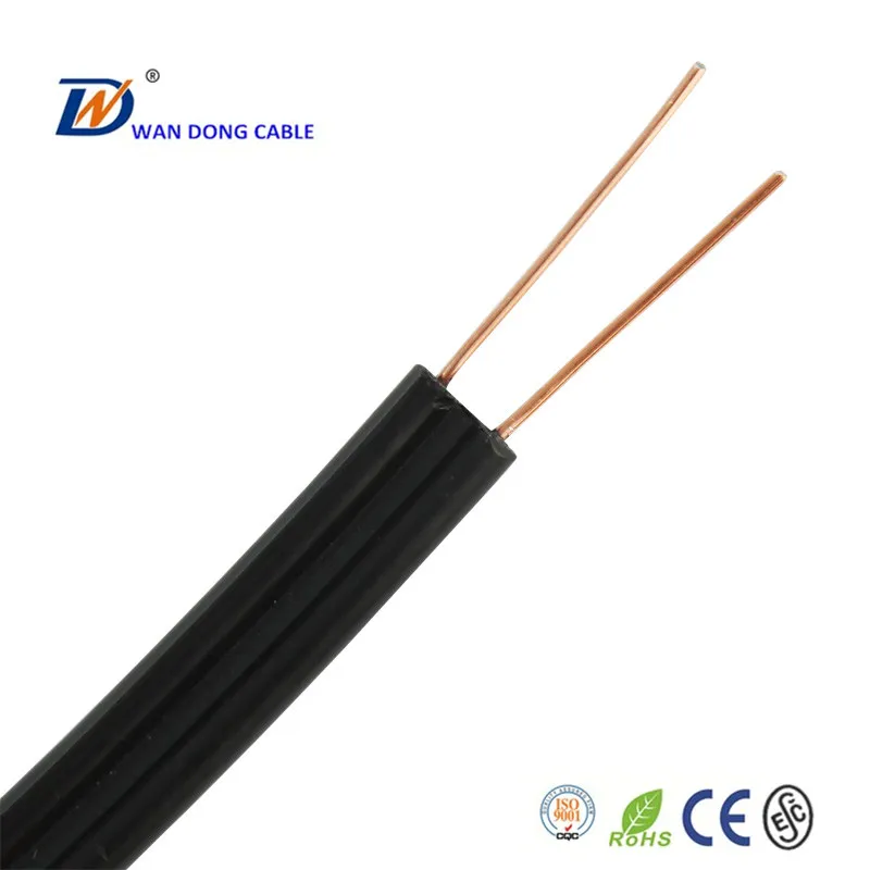

That cable is for indoor rated. It doesn't have any UV Resistance and the insulation will get damaged quickly when used outdoors.
This is the cable BSNL/MTNL typically use for DSL installations.
