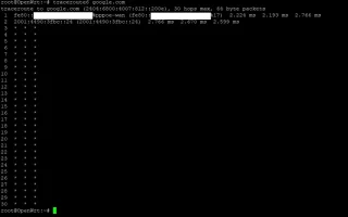

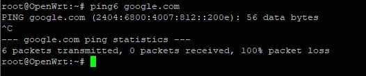

anyways, I can't ping from
LAN , Zero packets are being returned. Traceroute show a single Hop to the ipv6 address of Lan interface of OpenWrt i believe, and the next Hop is always Destination Unreachable [means there is a problem with the route?]Pinging within the router is more or less the same No response; traceroute shows single route to an address which is similar to an ipv6 address but in the WAN6 interface(in OpenWrt Terms).
Could this be a misconfiguration in my end, or is it simply that ipv6 just haven't been enabled for my area despite the address and PD?
I lean more to the latter, but the one thing that bothers me is
Traceroute ; a single Hop? Is there something off in that??plus there is an OpenWrt thread about the possibility of misconfig and route issue in ipv6, and i checked the routes with my with limited ipv6 knowledge, using
