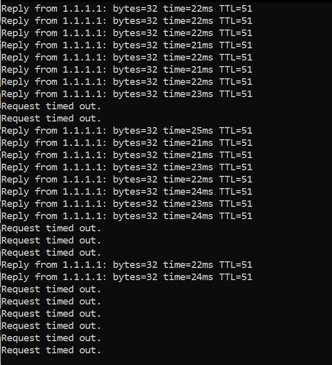

Now, the router runs fine over quite a few days. but after almost 2 weeks, it starts to slow down, like website taking longer to load.
When I ran background ping, I saw that router is giving request timeouts for few minutes and then again starts to work, and again stops after few minutes, and this cycle continues..
Please help me with the solution if anyone got it fixed.

Like in my case packet drops start to happen after the router is running continuously for about 2 weeks without any restart ( because I use always on UPS with router).
I think your router has some issues, because mine only starts to show packet loss / lag ( NOT HIGH PING as you can see my screenshot) only after it has not rebooted for several days and after restart the issue is completely and appears again after several days.
And I am on 100 mbps plan, and I don’t get packet loss like you said.
1. Do you get this issue even after restart ?
2. Also try to use jio router wifi/lan directly or in TP-Link in AP mode ( might be issue with tp link router )
