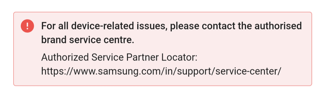

On a slightly different note, flipkart seems to have stopped processing return/replacement for defective phones/tablets (probably other things too, can't confirm) and instead redirects to visit brand service center, don't know how easy (difficult) would it be to override it through mails/calls

I would suggest you start a chat conversation, if it is in your favour well and good. If not, ask them to someone to call you to discuss this further. It is better to start early :)
