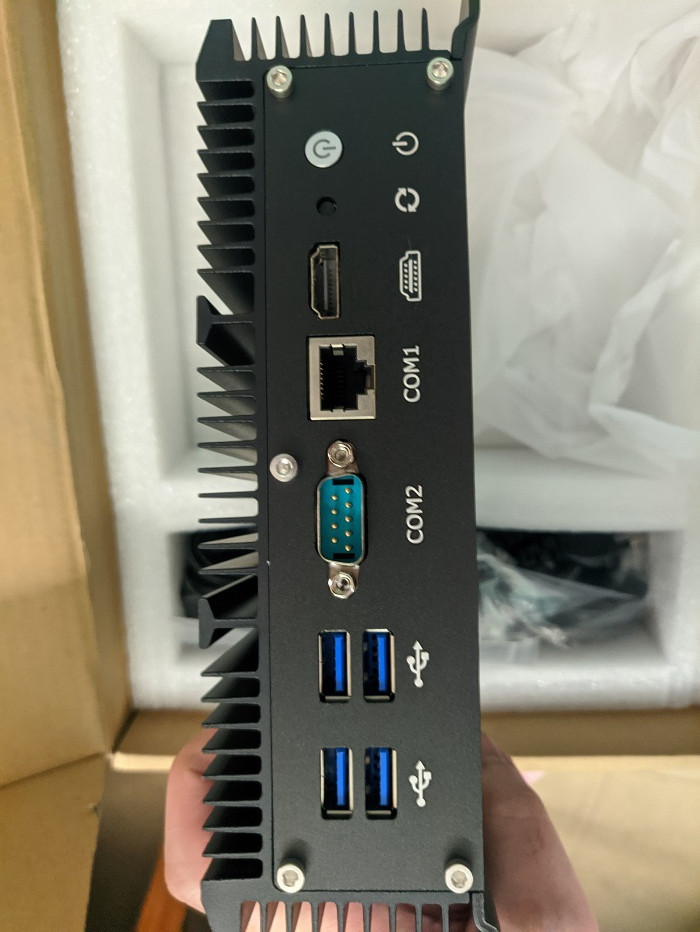

I had recently acquired a mini pc with 4 intel NICs to be used as an x86 router / firewall. More details around the process of acquiring it is in another thread - Important - All international "Gift" packages now liable for customs duty @ 41.2% | Online Shopping

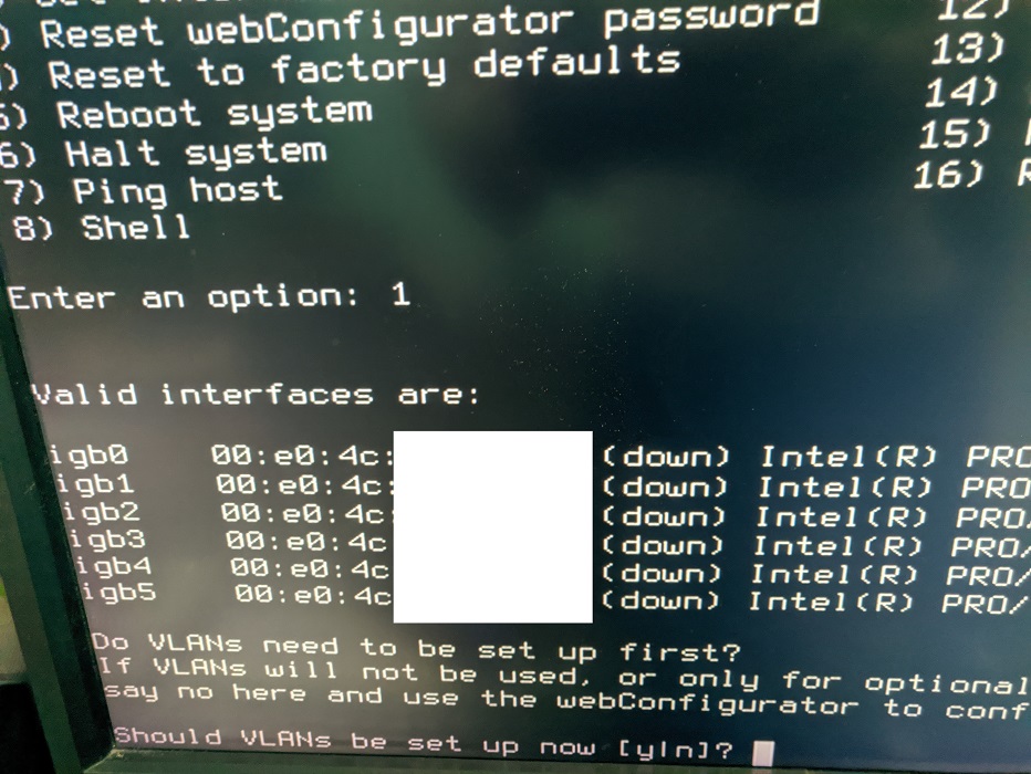

Now on pfSense, the UI is more clean and polished. The layout also seemed better than OPNsense. I did the same config on pfSense and here they were pretty direct and mac spoofing on VLAN interfaces is not supported and must be set on the parent interface (this is the feature request Feature #1337: VLANs with different MAC address than parent interface - pfSense - pfSense bugtracker). But the issue is, I need two different macs when talking to Kerala Vision and BSNL (as that's what is originally registered on their end and I didn't want to get it reset).
I anyway I found a work-around in pfSense forum (MAC address spoofing on VLAN's and impressions from a second-try user) where you need to create bridge interface with just the VLAN interface as a member, and on the bridge interface you can spoof the mac. So BSNL Internet was setup on the regular VLAN interface and Kerala Vision on the bridge interface.

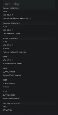

💪🏼 You'd have the pay by cash I think on delivery for FedEx.
DHL lets you pay online if required, they'd send a link where you can pay. Aramex also you can pay online.
I guess since its cleared as a personal shipment with 42% duty, got cleared quick or maybe Delhi customs is quicker 😅. My shipments take much longer with multiple queries from customs. 😞 All came through Bangalore customs though.

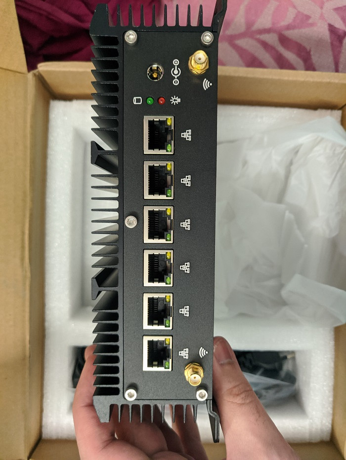

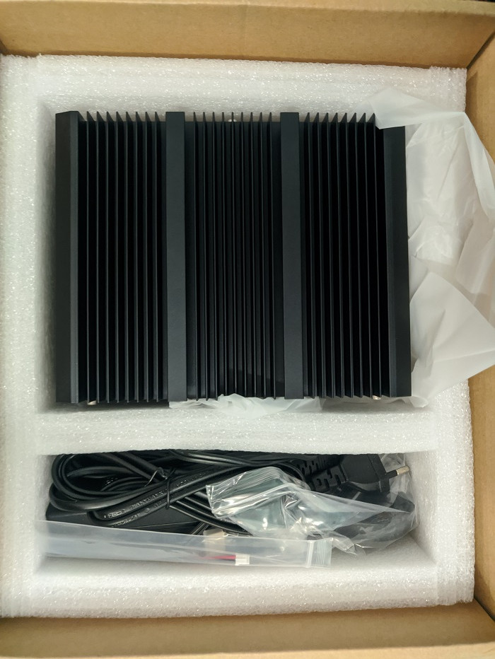

Got the mini PC today.Got charged ~4450 in customs and advancement stuff. FedEx gave the Personal Import IEC instead of my real one despite sending them my IEC by email even before parcel was picked up in Malaysia. So frustrating! Anyways its all working well now.

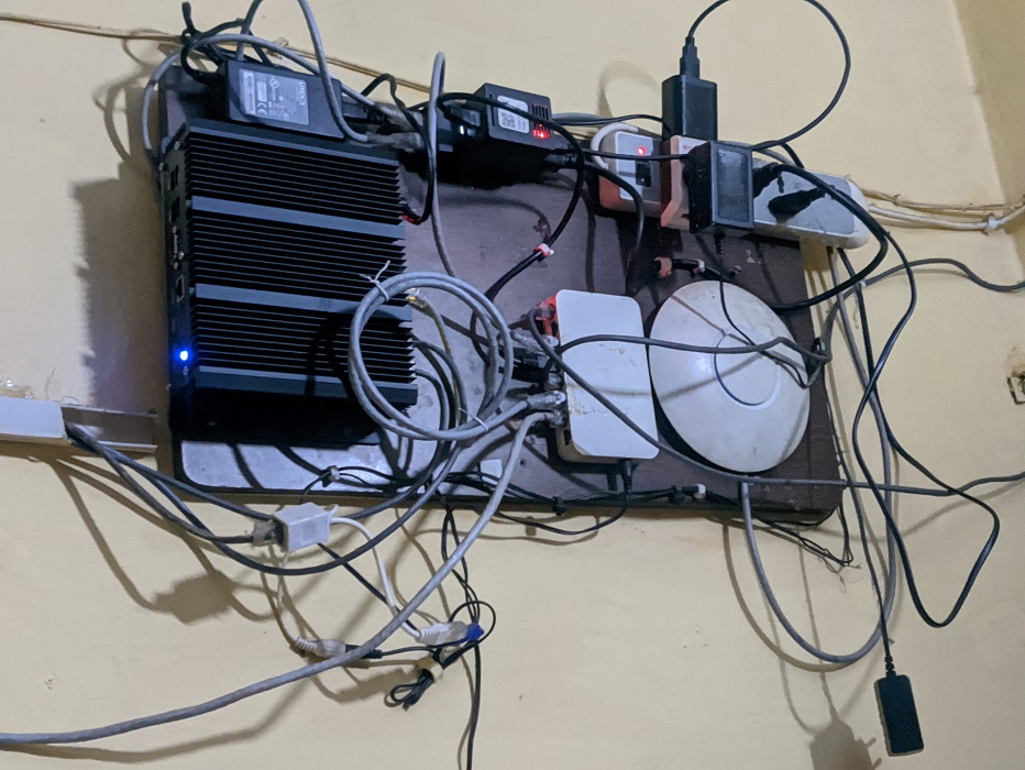

My networking wall is a cable mess, I should prolly get a rack:
