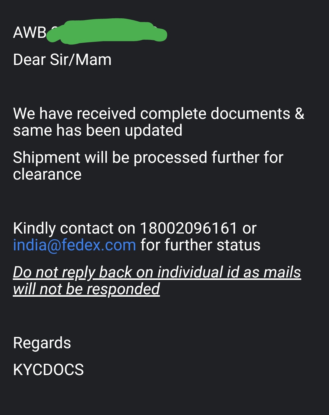

I had recently acquired a mini pc with 4 intel NICs to be used as an x86 router / firewall. More details around the process of acquiring it is in another thread - Important - All international "Gift" packages now liable for customs duty @ 41.2% | Online Shopping
