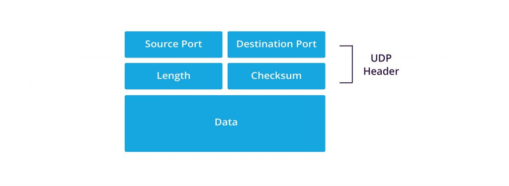

Ya that is because UDP has no flags or other data in the header . Data is just sent from source to destination with hopes that network doesnt drop it anywhere.
This is a UDP Packet
