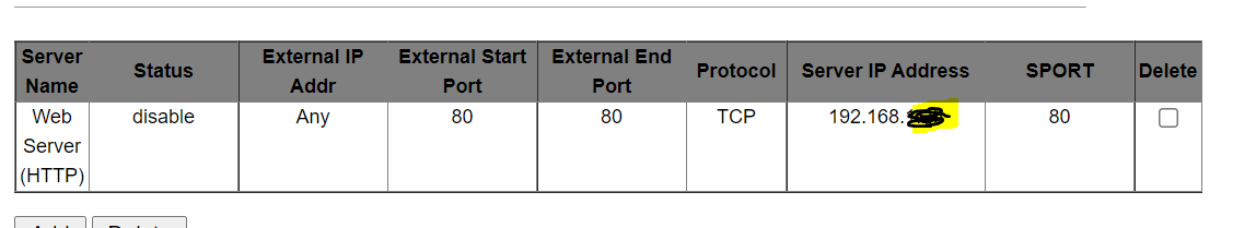

Thank you for this conversation. I did the configuration as you mentioned. But the status is showing disabled by default. Can you please help me on this. I have attached the screenshot below.
@CHOPSHOT
Thanks for replay and I had tried gathering some help from google, youtube etc, but unable to figure out, I suspect BSNL is blocking ports opening and forwarding , it would be great help if you can share your settings.
or with my experience/study I concluded that following things needs to be verified for this, can you help with below settings
1. Network -> Internet -> NAT Configuration , what is the NAT value, NAT1..NAT2. NAT3. NAT4 ?
2. Application -> Advanced NAT -> DMZ configuration needs to be disabled or enabled? I guess we need to give IP address of device which needs to get communications from Global IP to that device IP on particular PORT is it correct?
3. Application -> Advanced NAT -> NAT Configuration, I have few queries, What is " Server IP Addr" and "Internet IP Addr" setting to fill with? as per my understanding Server IP means the IP address of end device/PC and Internet IP means the Global IP allocated on particular instant (Static/Dynamic) , I am correct? please correct me with your settings.
4. apart from above, have you done anything on UPNP setting? Application -> UPNP -> UPNP Configuration
if we can workout and get success, we will make (I do it) document and publish here in the interest of others :)
