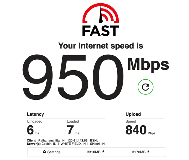

940 Mbps up and down. However, I faintly remember reading here that if I get a particular ONU with 2.5G LAN port, one can get over 1 gbps speeds. You also need to have the whole link chain... router, switch and your PC to be 2.5G capable.
