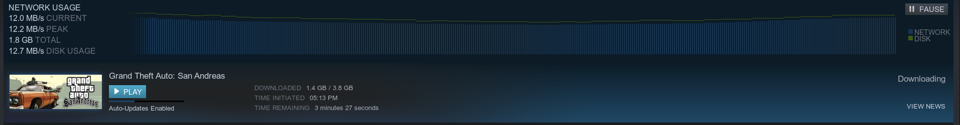

Steam:-
I’m able to hit 12MB/s on Steam almost instantaneously. Pretty good stuff:-
