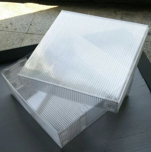

The Fiber has been terminated from black cable to yellow in a plastic termination box in something like this which is cheap on BSNL`s side
