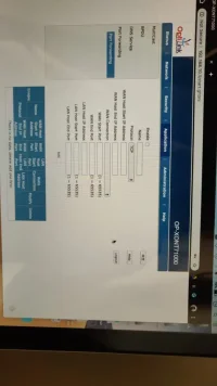

PS4 ( static IP 192.168.0.103) ( LAN cable)> Connected to Tenda WIFI Router ( LAN cable)> Connected to Optilink ONT (Products | MEN SWITCH, MEN SWITCHES, GPON ONT, GPON OLT, GEPON OLT, GEPON ONU)
I tried port forwarding on the Tenda Router but it didnt work.
Then after some research i found out that i need to opn the ports on the Optilink ONT.
Now my main question is how do i enable port forwarding on the Optilink ONT ???

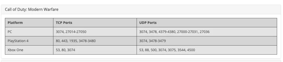

The ports i need to forward on the PS 4 are
PlayStation 4 TCP Ports 80, 443, 1935, 3478-3480
UDP ports 3074, 3478-3479
