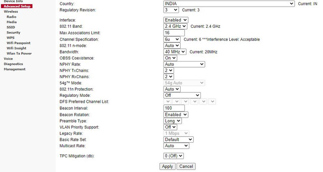

Hello All,
I am using Airtel fiber and i get 120 mbps speed on 5Ghz but on 2.4 Ghz i only get 40 mbps speed.
As per the 802.11n standard maximum achievable speed is 150 mbps. But i get only 40 mbps
Anyone knows the settings to achieve higher speed?
This is my router settings.

why does it say bandwidth 20 MHz even though 40 MHz is selected? That might make some difference

Change the “OBSS Coexistence” setting to “Off”. Your router should use 40Mhz bandwidth instead of 20Mhz.
I have faced this thing earlier, in Netgear routers, there is an option called “Enable 20/40Mhz coexistence” which means that router will automatically switch between 20/40 Mhz bandwidth’s based the less interference.
From the attched image the Bandwidth says 40Mhz but still the current is 20Mhz, so change the OBSS setting and you should receive 90+ speeds provided your link speed is 150Mbps.

I think this OBSS coexistence feature will vary from router to router. After reading here, checked my config on Nokia 2425-g, found no such setting, the frequency could be easily set to 20, 40 or 20/40(this could be OBSS) but no dedicated option.
I changed it to 40. Earlier speeds were 50mbps, post changing it rose to 90 Mbps.
