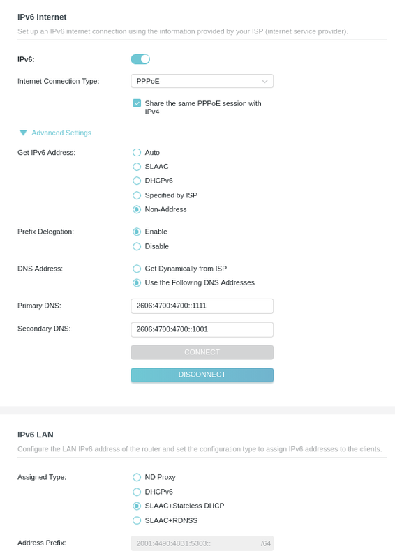

I tried enabling dhcpv6 but my devices aren't getting any v6 address with that.
The main issue here according to me is, I am receiving a somewhat ULA address (withing their network) but with a GUA prefix. I can access my v6 address via Jio cellular network but not when I use a VPN like Cloudflare WARP, I can use plain AAAA DNS record for a domain but not a cloudflare proxied one. I use Pi-hole as my DNS and I can monitor all the queries my devices are making and as soon as I enable IPv6, all the queries by my mobile devices are through IPv6. Now, if I am not wrong, any query made to a server outside of my accessible network (let's say hosted outside India) would simply not resolve unless it switches to IPv4. So, I see a slight to major drop in performance after enabling IPv6.

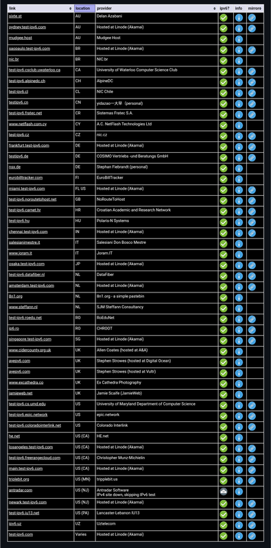

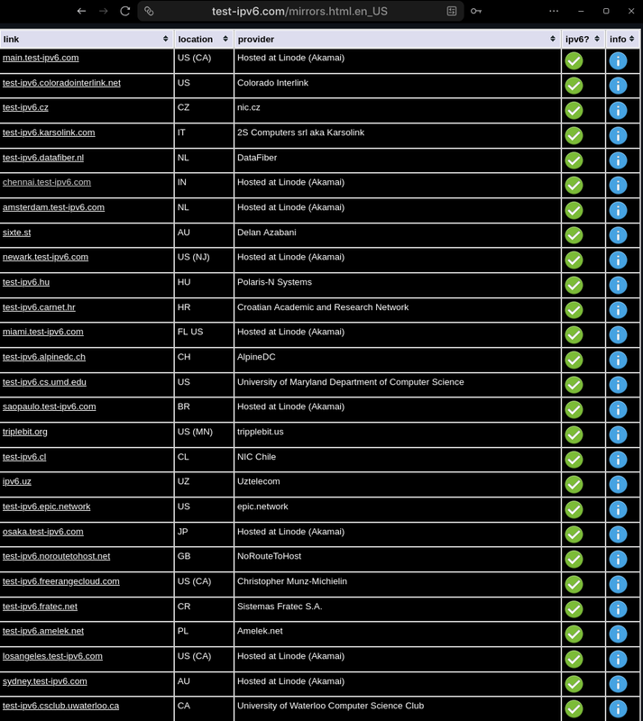

BSNL SDO enabled IPv6 between June and October 2025.
The IPv6 online testing platforms confirms IPv6 too.
