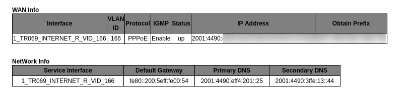

You’re absolutely right . I’m facing some issues while connecting to my access point(ax10) because of the IPv6 only connection
Update 2 for the IPv6 issue
At last my LCO updated the configuration IPv6 to IPv4/IPv6.
When the connection was in the IPv6 only mode I was able to get a IPv4 address when the IPv6 Is assigned ( I changed in the ont settings Ipv6 to IPv4/v6 yesterday and it worked)
so I tried the pppoe-wan obtain IPv6 manual and DHCP v6 client and attached the pppoe-wan in it’s device in the openwrt and got the IPv6 address assigned.
Currently when I try to disable the IPv6. It won’t work. So I find a solution I disabled the lan IPv6 option so device won’t get an IPv6 address

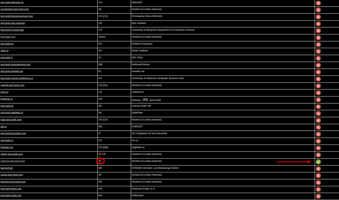

BTW I used the IPv6 and it’s completely broken and has unstable latency problem and I also faced YouTube buffering when I set the video quality to 4K.
