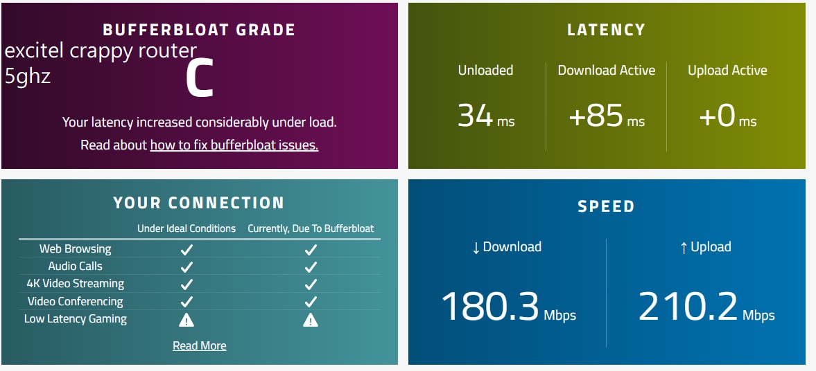

normal excitel router 5ghz mode -
@raj17 @Skye Seems Excitel hardware is also shitty but i confirm that JioAirfibre IDU is pretty rocksolid. There hardware is capable of handling speeds .

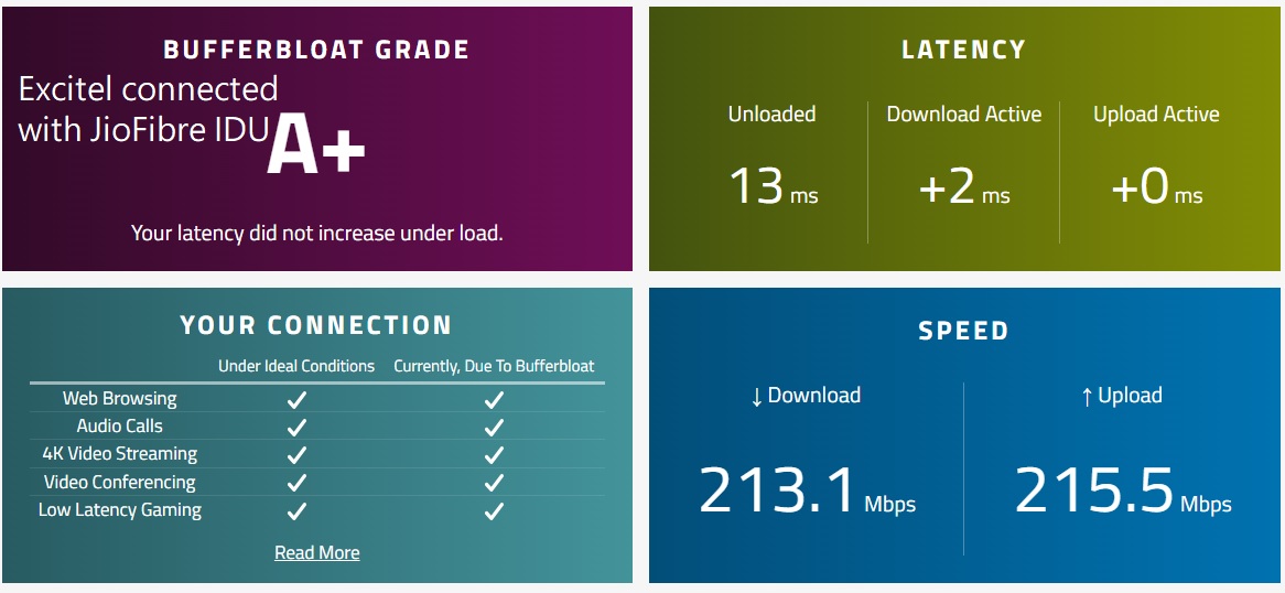

Update :-
Connected my Excitel router with JioAirfibre IDU
and here are the results -
@invisible007 Honestly this result surprised me too 😅
In theory when an ONT is running in normal (router) mode(not AP MODE), you usually expect bad bufferbloat, higher jitter, and latency spikes because everything is handled by ISP hardware(Excitel ONT). But here the Jio AirFiber IDU is doing the opposite bufferbloat stays at A+ and latency barely moves under load.
That clearly shows the issue isn’t the line or ONU itself. The real problem comes from router side QOS management and Wi-Fi handling AND ALSO 6GHZ (JIO AIRFIBER ONT). With the Excitel router even though the ONU is fine the router struggles under load, causing high latency and jitter.

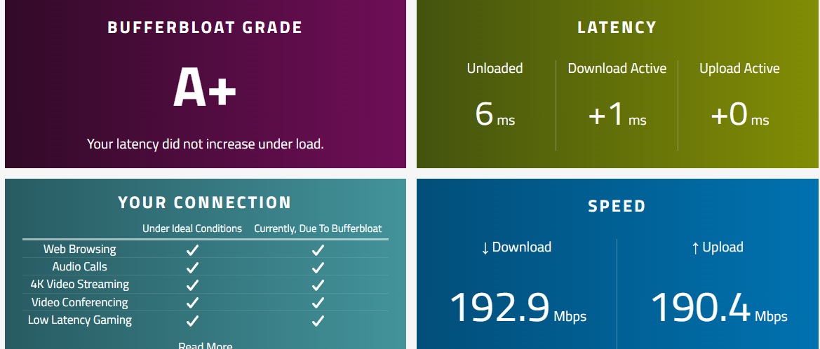

@raj17 yes these tests were performed on wifi
now here is the test done on LAN -
unloaded latency is always 5~6 ms , and Download active is stable 0~1 ms ..

Bro Those LAN results are honestly crazy good 6 ms latency with almost zero jitter +1 ms is basically what you’d expect from a local network. The problem isn’t the connection it’s pretty clear the stock Excitel ONT is the weak link here.
