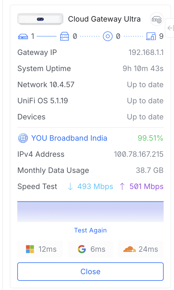

root@Cloud-Gateway-Ultra:~# busybox traceroute 202.94.70.1
traceroute to 202.94.70.1 (202.94.70.1), 30 hops max, 46 byte packets
1 100.78.0.1 (100.78.0.1) 2.042 ms 3.661 ms 4.115 ms
2 Pune-Core01.youbroadband.in (203.187.215.1) 5.185 ms 3.049 ms 4.800 ms
3 123.63.152.142 (123.63.152.142) 1.956 ms 6.074 ms 3.817 ms
4 182.19.108.217 (182.19.108.217) 24.751 ms 26.103 ms 23.654 ms
5 sng-b5-link.ip.twelve99.net (62.115.46.106) 56.122 ms 58.559 ms 55.791 ms
6 starhub-ic-359575.ip.twelve99-cust.net (62.115.164.217) 57.174 ms 59.038 ms 59.560 ms
7 203.118.6.234 (203.118.6.234) 59.358 ms 203.118.7.74 (203.118.7.74) 59.260 ms 203.118.6.234 (203.118.6.234) 58.388 ms
8 202.94.70.1 (202.94.70.1) 59.535 ms 59.678 ms 60.168 ms
root@Cloud-Gateway-Ultra:~# busybox traceroute 217.38.149.236

@Lolita_Magnum traceroute on wired connection. you were right!! I had Airtel in load balancing mode earlier so it must've used that on WiFi for tests earlier..
@unnecessary here you go!

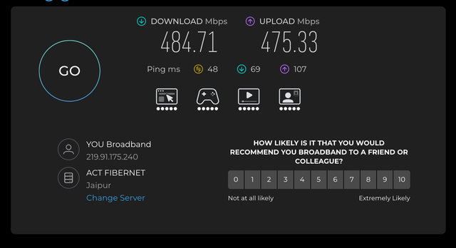

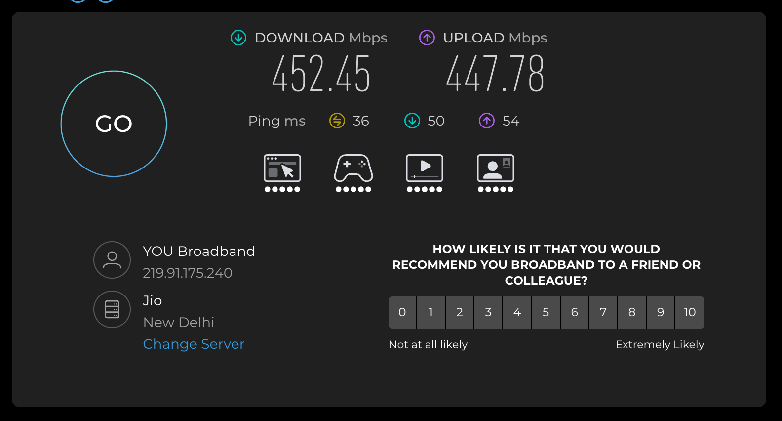

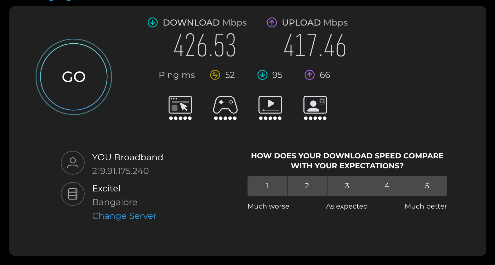

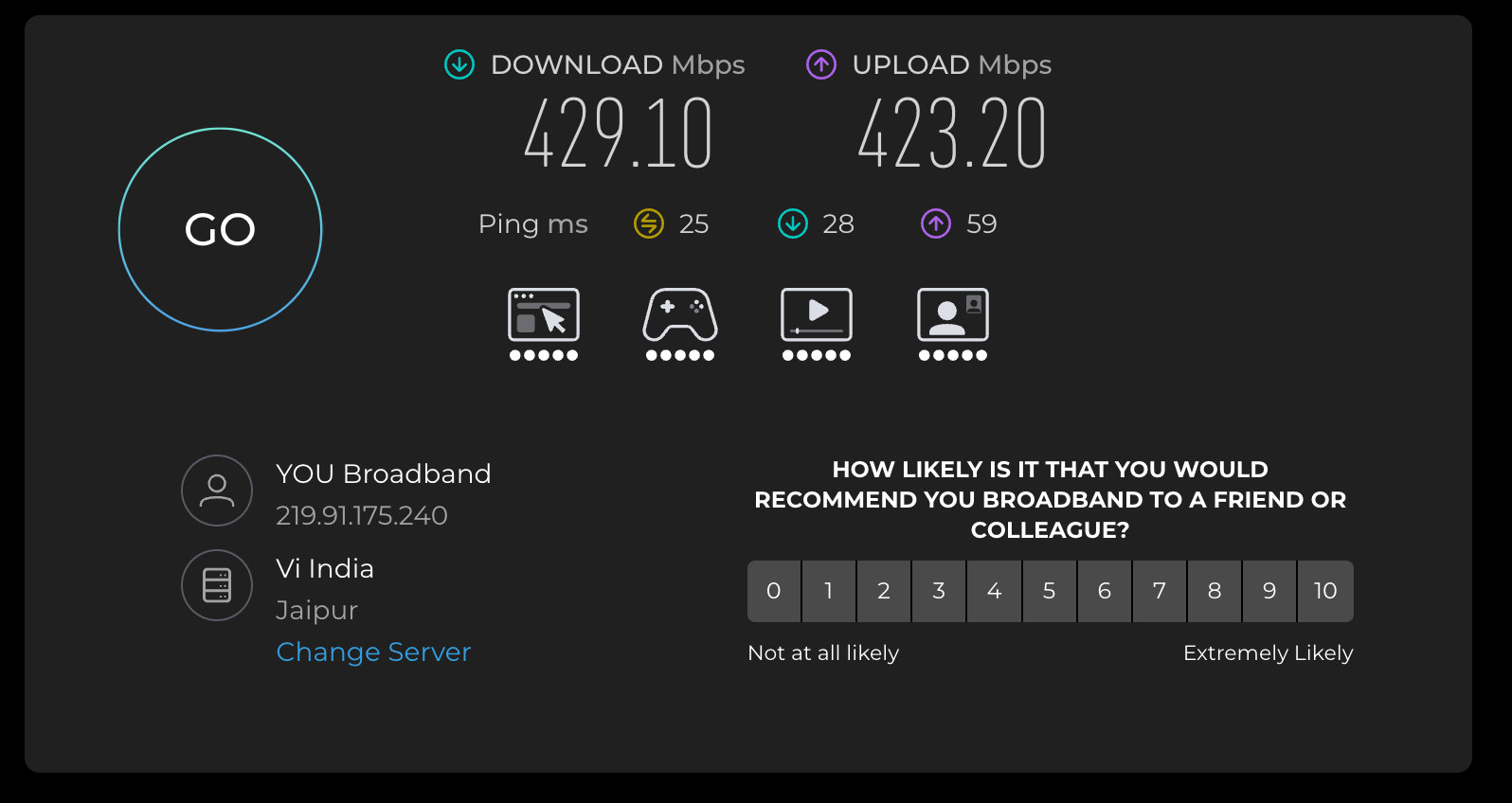

Ubiquiti Mumbai Speedtest Sever (Wired)
Vi India Jaipur Speedtest Server (On 5Ghz WiFI AP)
ACT Jaipur Speedtest Server (On 5Ghz WiFI AP)
Excitel Bangalore Speedtest Server (On 5Ghz WiFI AP)
Jio Delhi Speedtest Server (On 5Ghz WiFI AP)
@Kaiju404 I can't edit post for some reason 😭
