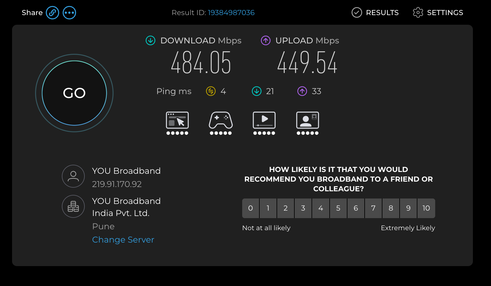

Local (Pune):
  • Download: 484.05 Mbps
  • Upload: 449.54 Mbps
  • Ping: 4 ms unloaded, 21 ms loaded down, 33 ms loaded up

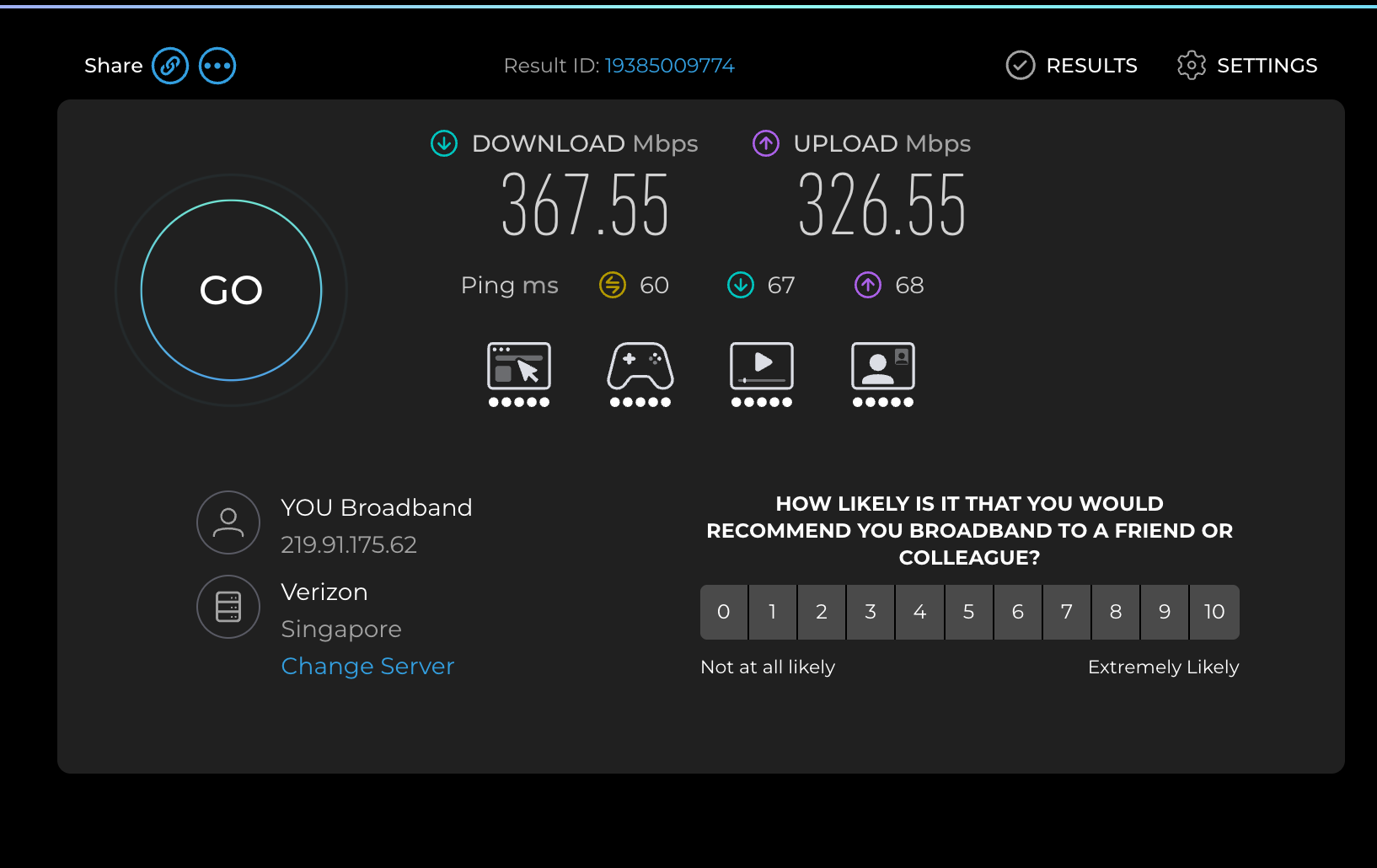

Singapore (Verizon):
  • Download: 367.55 Mbps
  • Upload: 326.55 Mbps
  • Ping: 60 ms unloaded, 67 ms loaded down, 68 ms loaded up

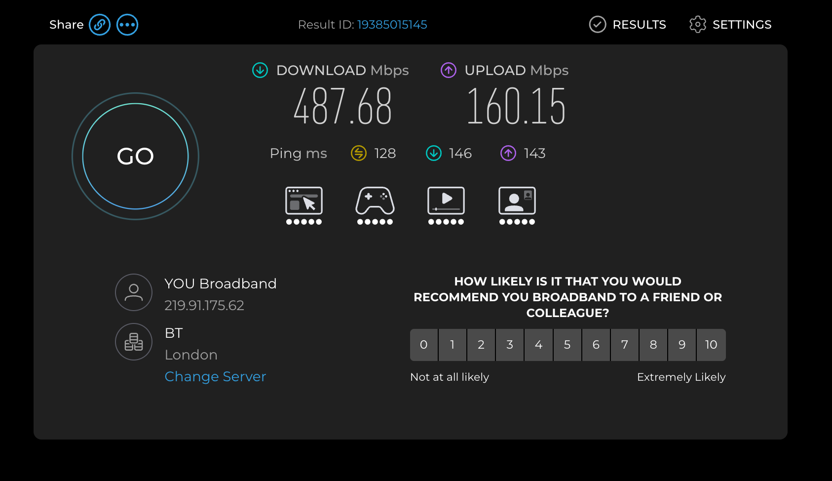

London (BT):
  • Download: 487.68 Mbps
  • Upload: 160.15 Mbps
  • Ping: 128 ms unloaded, 146 ms loaded down, 143 ms loaded up
Local numbers basically hit the plan ceiling even over Wi-Fi on a busy network. International download holds up well too, though upload clearly tapers off on the longer routes, which makes sense given the distance and number of hops involved.
