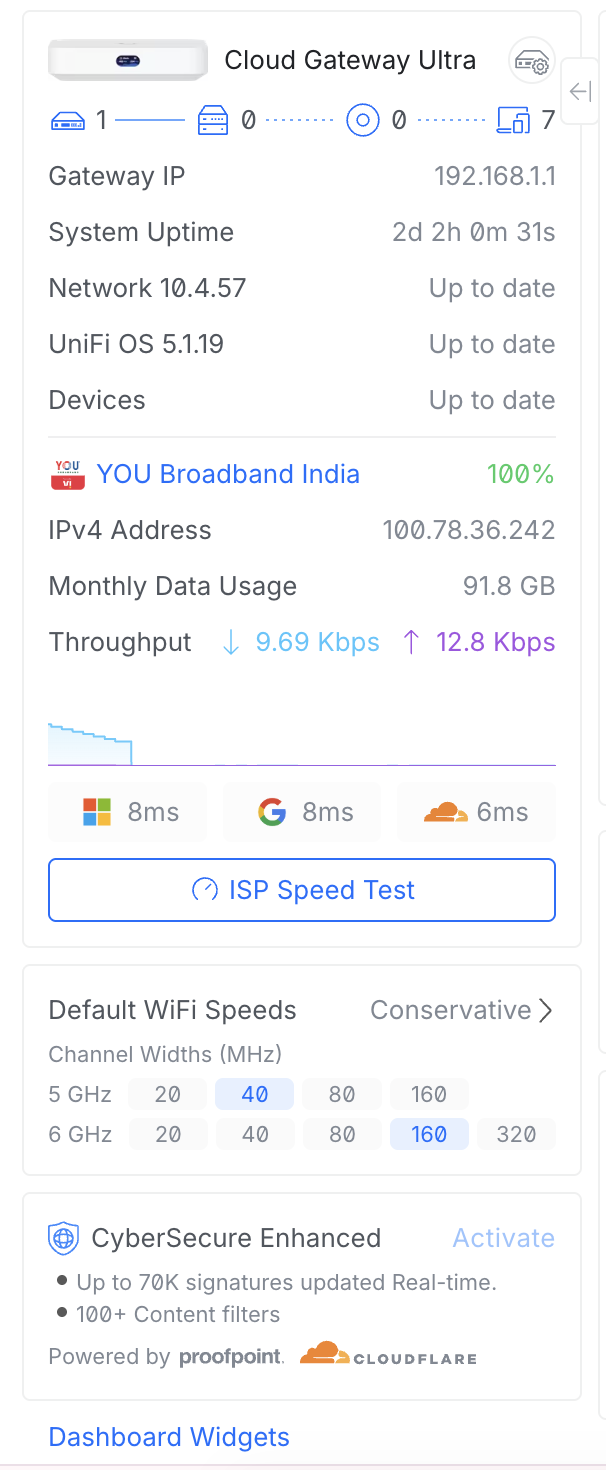

  • ISP provided router: RLTech dual band GPON router (currently running in bridge mode)

The ISP supplied RLTech router has been in bridge mode from day one, so it's basically just doing GPON duty. I started off with a Mikrotik hEX behind it, and have since moved to a Ubiquiti Cloud Gateway Ultra, which has been handling routing duties nicely.
Connection Basics​
  • Optical Power (Rx): -16 dBm, stable
  • WAN Type: CGNAT (100.78.x.x range)
  • IPv6: Not provisioned
  • Connection Mode: PPPoE
