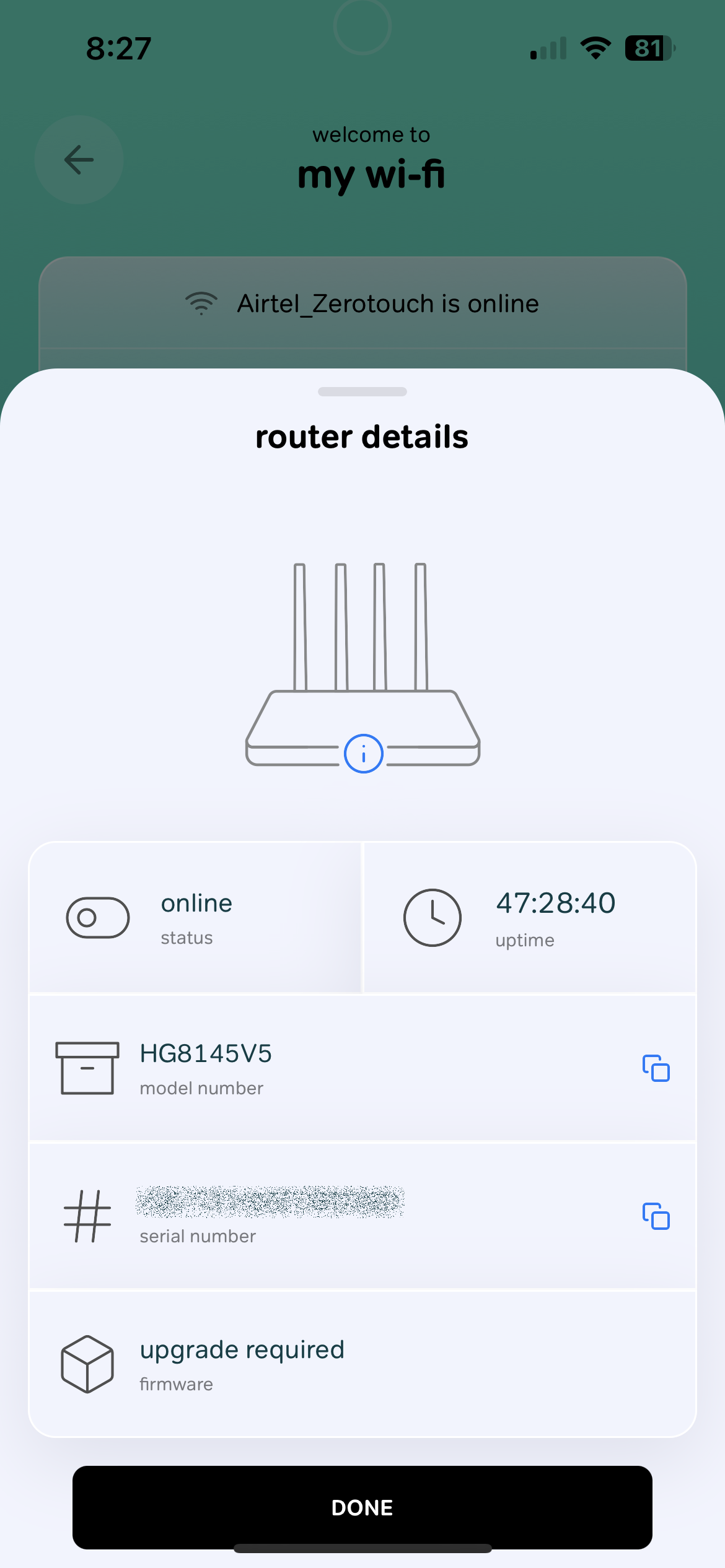

Airtel app says router update required, but there is no option to update the router, any guide on how to update the firmware?
