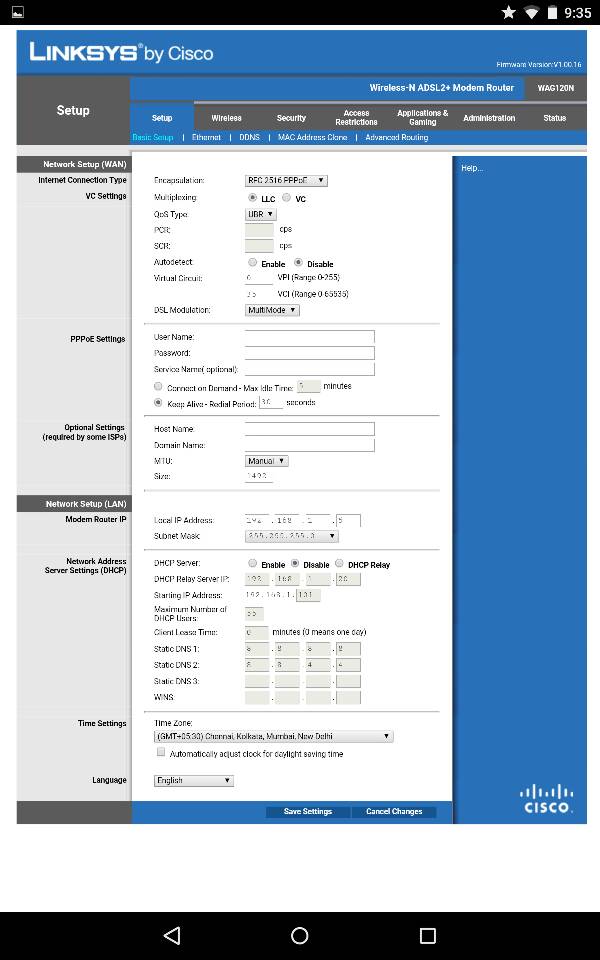

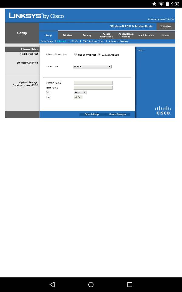

The method suggested earlier does certainly work. I am using BSNL FTTH since two years. Earlier I had DSL connection with my Linksys modem. After getting FTTH I used the same modem. First make sure that DHCP is enabled in Fibre modem. Then connect the Internet Port from Fibre Modem to your ADSL Router with RJ45 cable to 1st LAN port of your ADSL modem. Make sure you disable DHCP on your ADSL modem. ( In short just make sure that you use it as a router)
I am also attaching the screenshots of my Linksys modem.
Moreover I also have setup a WDS system that a Cheap TP-Link router offers to extend WiFi range. So after setting WDS between my Linksys and TP-Link Router I just have to connect the TP-Link router to power & it starts distributing original WiFi connection. Just like a repeater.
