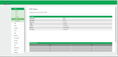

Please provide us a screenshot of PON status page.we can help thereafter.
If upload speed is zero,you would not have been able to use internet...AFAIK

The optical signal is weak.Ask the LCO to transmit more powerful signal from their OLT.
It is as simple as this.
Now,why the upload speed is zero,because the transmission from OLT is always more powerful as compared to ONT.
Thus,you can receive signal,but transmission from your ONT is barely enough to to make considerable upload within the given timeframe as per PON standards.
Please contact your LCO.

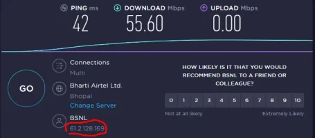

@ Kick933
Thanks you. I did not understand all of what you said but I urged them to check for the power and in their opinion following power is too much and that may be causing the problem they will also check for bends and stretches.
Rx Power-30.969100 dBm
I am attaching a scrrenshot of the speed test and could anyone please shed some light on the weird IP (this should look like 117.xxx.xxx.) encircled in red in the screenshot

The power is too low,not high.
This is IP Address assigned to you by BSNL.
