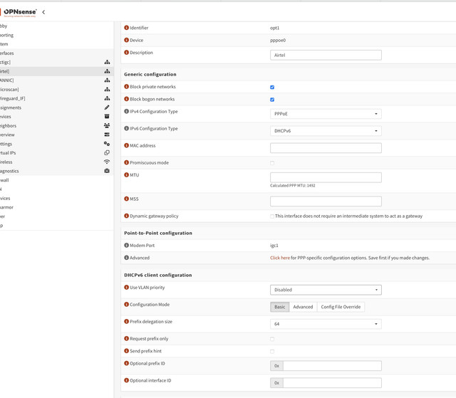

On my airtel line, I need to set the following on opnsense
DHCP Configuration type - dhcpv6
PD size - 64
Request Prefix/ PD hint : Disabled
However for ACT, Tried both dhcpv6 and SLAAC but no luck.
would really appreciate If anyone using ACT with working ipv6 could post their PPPOE settings from whatever router they are using

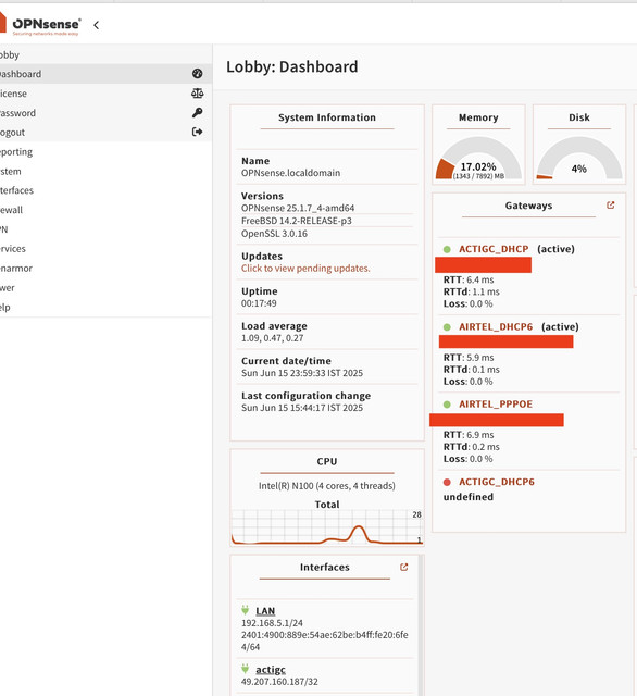

Airtel ipv6 is straightforward and is working as expected.
If you look at the screenshot below, my Airtel connections shows up as two distinct gateways - one ipv4 (airtel_pppoe) and the other as Airtel_dhcp6
The second screenshot has settings for the Airtel interface
I am trying to figure out what settings are to be used for ACT to also shows up as a dual stack connection
Currently its establishing a single stack ipv4 connection (ACTIGC_DHCP)

PPPoE with ipv6 configuration type as dhcpv6, PD size of 64 and request prefix/ send prefix hint to disabled/ unchecked
The Airtel one is set similarly with one key difference being that the Airtel CPE is set with VLAN enabled and VLAN ID of 100
I think you need to enable prefix request, see my screenshot in the previous post. Left one is ACT and right is Airtel setting. Yes, in my case also, no VLAN for ACT and for Airtel its 100(though i use 1503 due to ALC OLT, but thats different topic).
