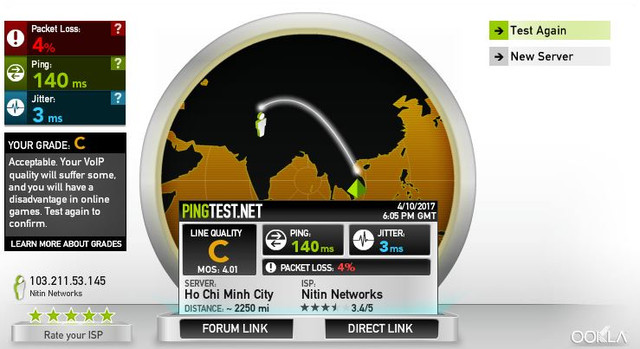

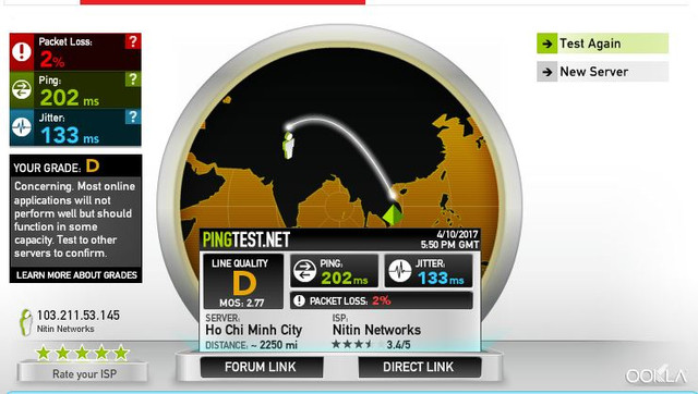

@Excitel Since 9.20am today I'm facing a huge packet loss in my area. Already raised complaint but no action is taken from your end.
Anything above 0% is total nightmare!

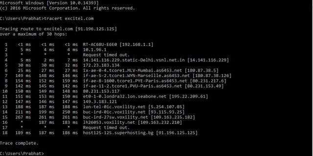

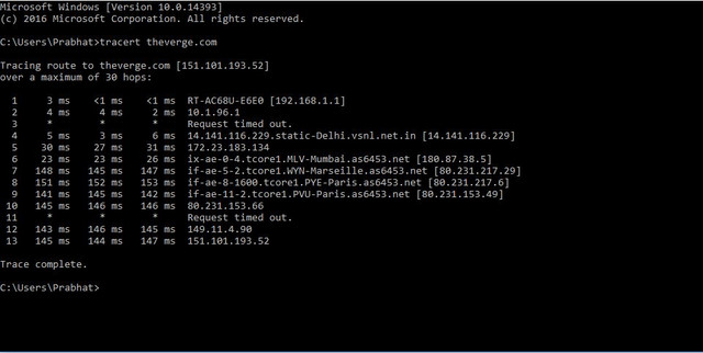

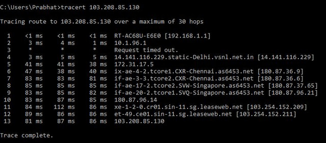

Do a tracert to Excitel. If it is okay, try with Indian server not on their network. If all is ok, problem should be with Excitel provider so try to foreign server and see.
Here are the results:
excitel.com: Note the packet lost after hopping from sub-switch 10.1.96.1 9 (3rd hop) and 17th hop
theverge.com: Once again 3rd hop and 11th hop

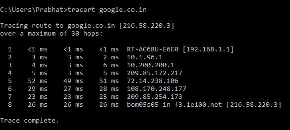

google.co.in:
Interestingly 3rd hop revealed their main switch.

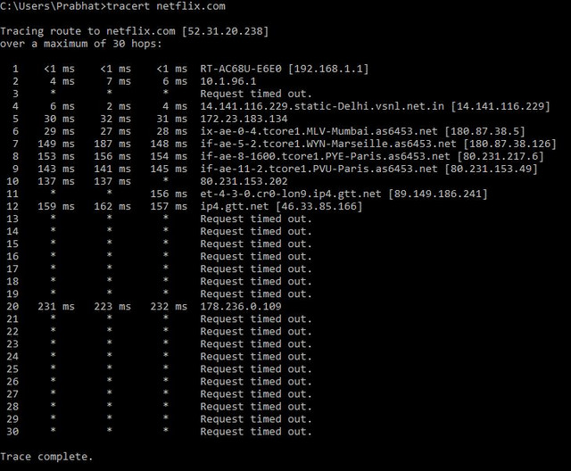

netflix.com: TOTAL SHAM that they are providing peering for Netflix. Almost all packets were lost when tracerting Netflix.com using @Excitel.

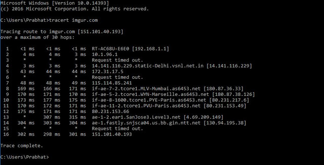

imgur.com: I couldn't even upload images using imgur because uploads were either getting stuck midway. Guess what packet lost in between.
103.208.85.130: A famous Left 4 Dead 2 game server in Singapore. Once again note the 3rd hop. Cause for huge sudden spike in latency when playing.

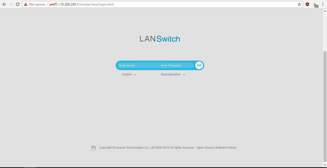

1. Main switch on 10.200.200.1 will time out for every tracert to any foreign server.
2. This switch is Huawei Technologies made.
3. Almost all foreign traffic also time outs at some last point. Maybe 2 or 3 hops before the last checkpoint.

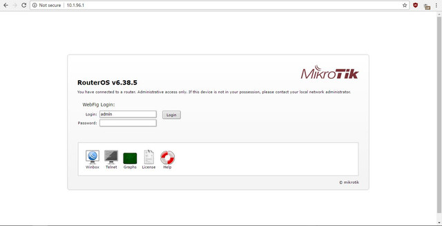

4. Sub-switch is running on MicroTik
