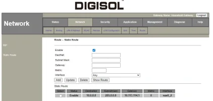

Add a Static Route to the SIP Server. You can add the IP directly like I did in my previous post. But that way you will have to add the return route too which is not there in my previous post. In my case, the return route is 10.x.x.x which is the same with my SIP server so I have to add only one route entry and be done.

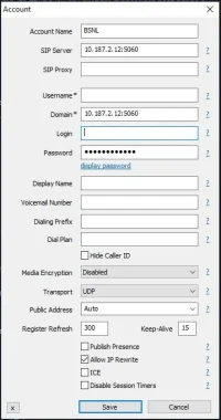

This is for MicroSIP. Click on the top right corner button -> Add Account. Don't forget to tick Allow IP Rewrite.

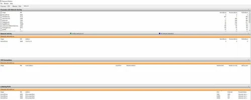

Resource Monitor showing MicroSIP info when it's idle not dialing any number.

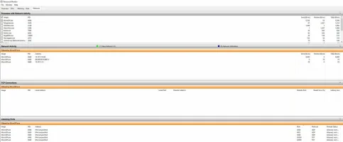

Resource Monitor showing MicroSIP info when I dialed a number. See the change under Network Activity. Now there is another IP which will receive voice and reply which I will receive on my static VOIP IP which NAT will take care of and send to my local IP.

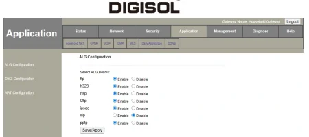

Tick "Turn off LAN DHCP" on Voice Internet configuration and Enable SIP ALG. Didn't think disabling DHCP makes SIP ALG function properly. Really hard to know which option does what without a proper manual.
Also, those who have DHCP instead of Static in Voice Internet configuration, everything else is same.
