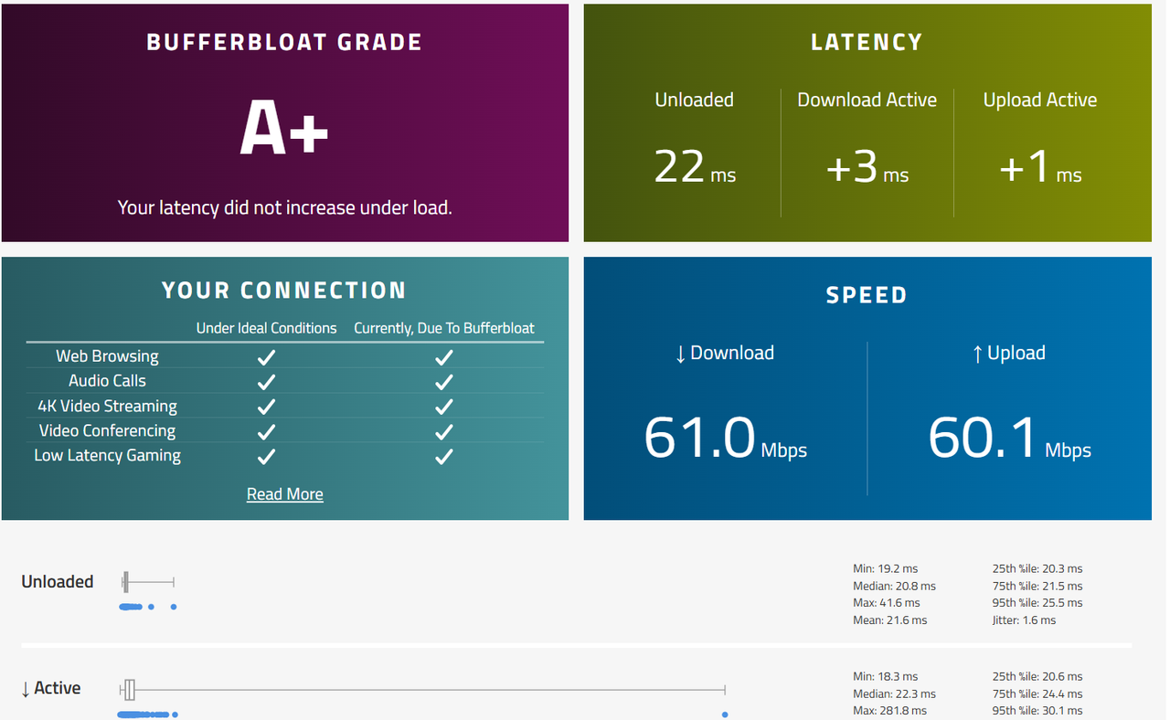

bro ,i installed openwrt , but i do feel its not better than asuswrt ( something is wrong from my side )
however ,both in bufferbloat test ,got A+
but to achieve A+ by openwrt ,it needed to lower the bandwidth to 55000 ,whereas asuswrt giving A+ on 60 mbps limit
however openwrt gives 0+ on active download and 0+ on active upload
but unloaded latency is higher on openwrt
is im doing anything wrong ??

1. yes im using sqm cake
2. my plan is 60 mbps ,i gets around 65 + mbps ,and i set in sqm 55000 kbps
i testted without sqm ,im getting 65+ mbps download and 70+ mbps upload and also checked bufferbloat test ,gets grade D ,
tell me what config you need ??
all im saying ,openwrt feels heavy
with asuswrt ,i gets A+ grade with increase in latency within +3 ms thats too with 60 mbps bandwidth limit
but with openwrt ,it gets A+ grade with increase in latency within 4-5 ms with 55 mbps bandwidth limit
im not saying ,openwrt doest working ,it working ,but it should perform better than asuswrt , and their is a lot of setting in openwrt ,im feeling ,something im missing so that openwrt not performing 100%
