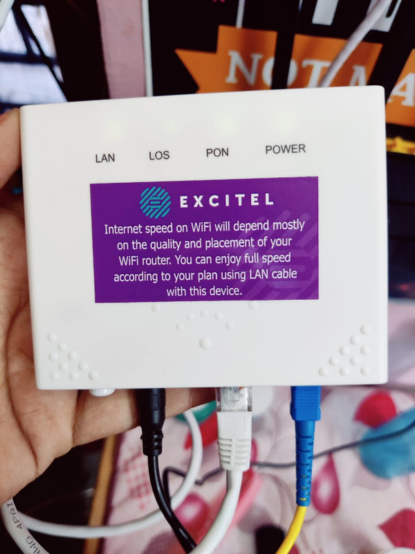

Finally got my Excitel 2k ONU+Router combo replaced with Rs 1000 ONU only... LCO replaced the unit within 2-3 days of opening ticket.. although on call he said it might take 1 month or more...Don't know which brand ONU it is... there is no mention of it anywhere... yes it is gigabit capable... I am using 2 Archer A6 one as router and one in AP mode....
Upvote 0
Yup that seems to be the one.. Any way to login into the ONU without ethernet cable directly.. ? I have a macbook.. so no ethernet port
Default gateway for ONU is 192.168.1.1 but it's not opening anything when on wifi... My Router is at 192.168.1.2..
