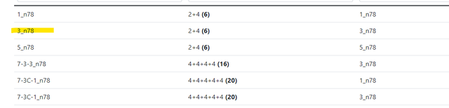

Can someone explain me how to read cacombos. For example 3_n78, does that mean n78+n78+n78 ?
@Kauban If you want to play around and see whether it suits your use case, you can try the Mi Router 4A Gigabit, its right now at Rs 1299 or so which is pretty cheap. Same hardware as more expensive units from TP-Link etc. You'd not need WiFi anyway right.
@dexter22 I think those are the CA combinations in NSA mode where LTE and 5G are used together. The 3 would be the LTE band, and n78 the 5G band. For 5G only combinations, you might need to look if it does n78_n28.
