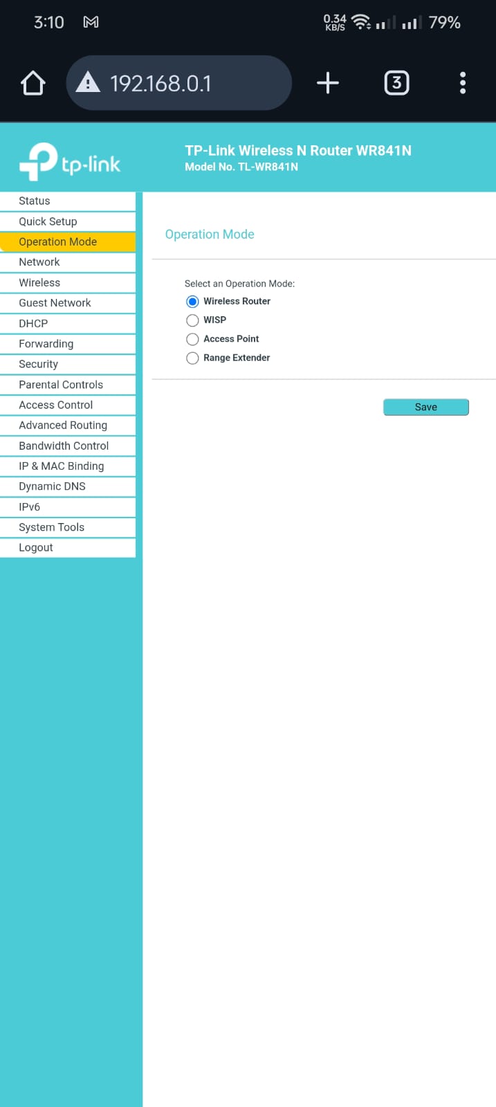

@raj17 Just connect your Jio ONT with your TP-Link router. Make sure your router is not in Access Point mode. You should see QoS option in Advanced section.
This is how it looks in my router:

@Zuke ok you said that i can improve loaded latency? i have one extra old TP-Link router, could you tell me the process?
Connect TP-Link router in access point mode to your JF ONT. Then try to find QoS/Bandwidth limiting feature in TP-Link Router. if you are on 30mbps plan, set QoS configuration to 26mbps and you should be good to go. This will not eliminate the whole buffer bloat issue but something is better than nothing.
