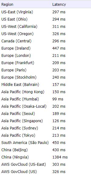

  • AWS Ping test(Ignore few irregularities)

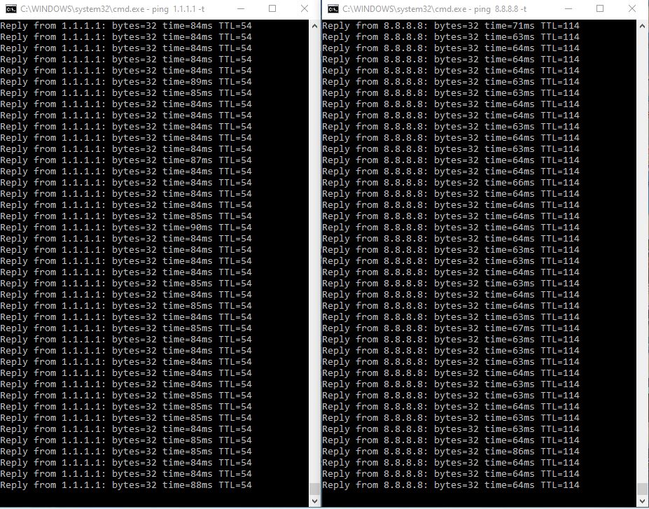

  • DNS servers pings: (Fairly stable)
Surprisingly, while writing this post, Cloudflare's DNS is pinging at 110ms

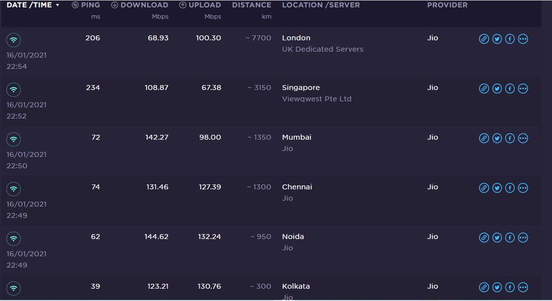

  • Few Speedtest results:

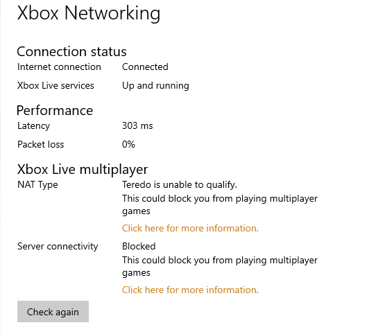

  • NAT Type: Strict(No change with UPnP)

  1. Very High ping even on local servers. Same with those in SEA and EU.

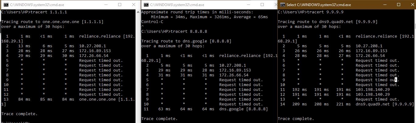

  3. Traceroute displays almost no information
  4. Strict NAT
  • Sample traceroute results

No better way to put it than to say that you've been served with a lemon. Here's my speeds and latencies on jiofiber (damaged ethernet cable limiting to 100mbps). International upload seems to be suffering at the moment but doesn't really affect my needs.

The traceroutes are attached as images. I'm not sure why the traceroutes do not show each hop and instead show request timed out, this doesn't happen on any other ISPs I have used. Other than that, these are just few servers which I've mentioned, every single server has high ping, be it Mumbai/Chennai/Singapore. On speedtest, Jio Mumbai server shows 75-70ms but still pings on other servers in Mumbai are 90+. Even the closest Jio server(Asansol) has 25-30ms ping which should be nothing more than 3-4ms as my main internet connection has 6ms till Kolkata and 35ms till Mumbai.
My experience says that the issue is with the routing and my traffic is not going through the right path(Maybe <MY-CITY> ->Kolkata->Mumbai or <MY-CITY> ->Mumbai)
