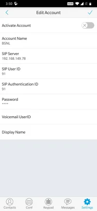

In GS Wave, you could use the following settings
Code:
SIP Server: 192.168.149.78 or kl.ftthvoip.bsnl.in (Please note only one of these would work, depending on how your VOIP account is provisioned)
SIP User Id and authentication Id: 91<std code><voip number> (for example 9148429xxxxxx)
Password: 0000 (yes it's stupid)

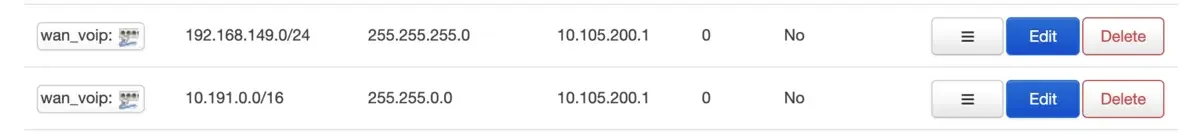

You'd also need to add static routes to that the VOIP traffic goes via the VOIP interface and not through the main internet gateway. In addition to the route to the SIP server, you'd also need to add the route for the destination 10.191.0.0/16 to go via the VOIP interface.

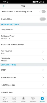

Now in GS Wave, you need to set the IP address of your router where siproxd runs as an outbound proxy.
With this, you would be able to make and receive calls as required.

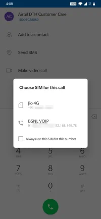

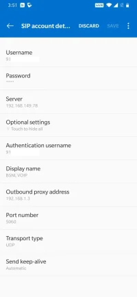

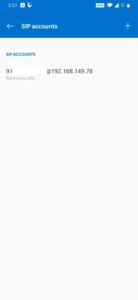

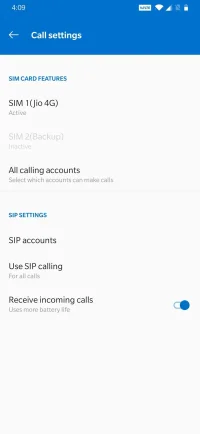

You could also use the built-in SIP client in Android, screenshots from my phone below.
