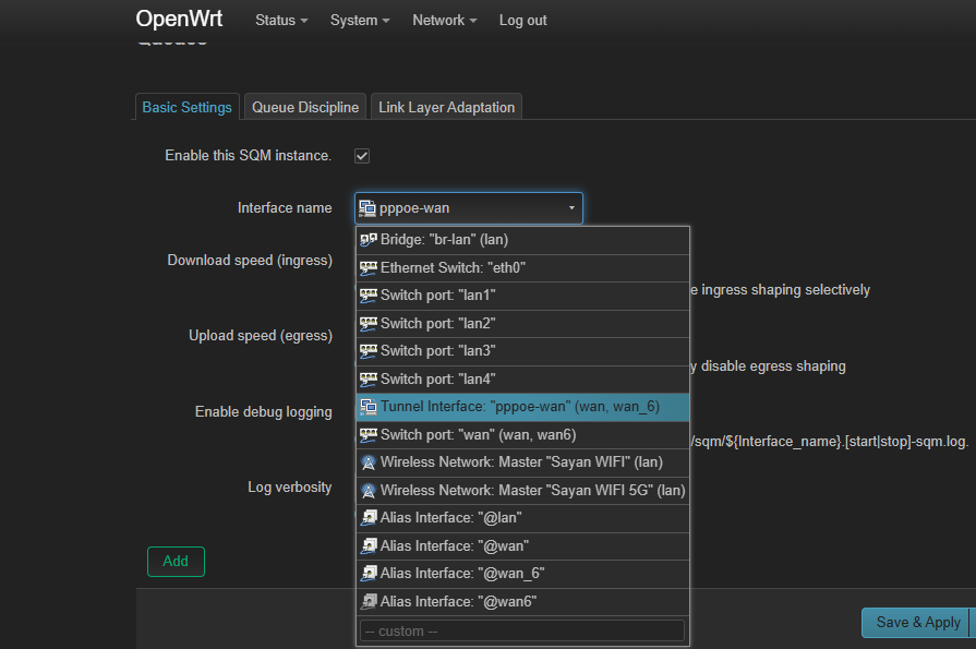

Which interface i should select?
on LAN getting very good loaded and unloaded latency.
but on wifi 5ghz its lesser but not as close to TP-Link which i showed you yesterday.
see its tested on smartphone: Bufferbloat and Internet Speed Test - Waveform
vs LAN: Bufferbloat and Internet Speed Test - Waveform
Upvote 0
