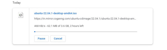

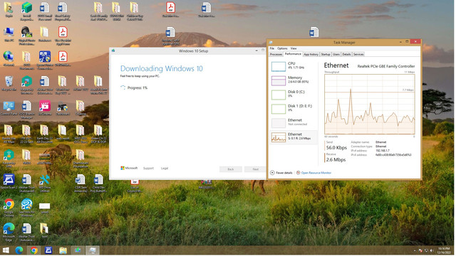

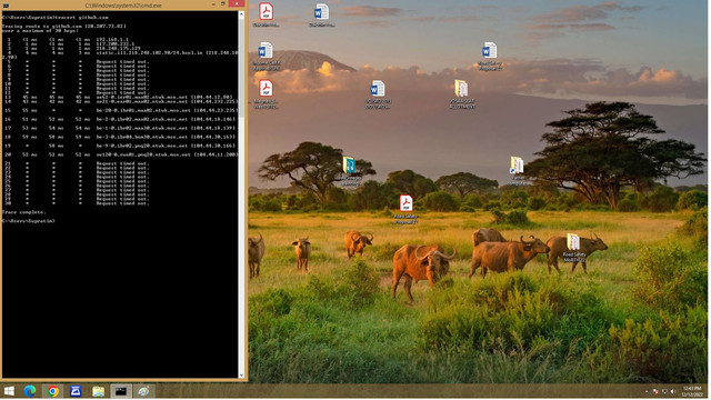

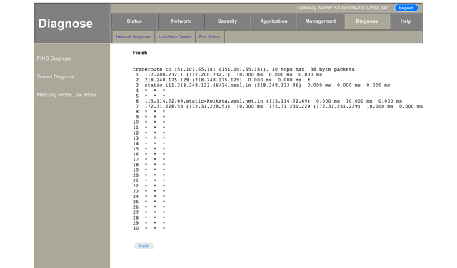

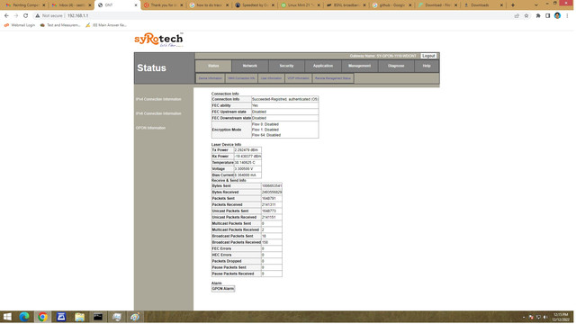

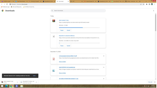

Hello everyone so after weeklong talking with nib I have got no positive result. The say to me that they have booked docket wit noc Bangalore but they couldn‘t find any problem. Yesterday I noticed that even download from Microsoft is slow I am on windows 8.1 and I thought of upgrading it to windows 10 but see the result in the attached image. I have included few more traceroute. Also all these problems go away when I connect to Cloudflare wrap surprisingly I could not use my Nord vpn because it’s failing to connect. Don’t know what to do any suggestions to get out of this problem any troubleshooting methods to find out the problem by myself or nib you can suggest. @netomato@f0r3he4d@sloj@Oppili
Source@Trex also I am facing buffering problem on my live tvSony liv which my mom watching for past 6months never faced any buffering after 6 December I am facing this -19 pon power don‘t know what the issue.
