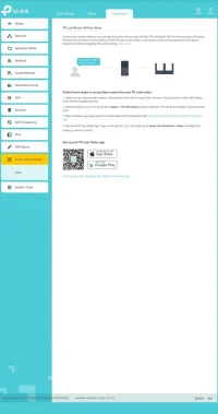

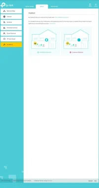

I have just received the much awaited C6 from Amazon.
But it got a wired issue.
I have set the dumb ONT into transparent bridge mode and router usually work great after setting up my BSNL FTTH profile.
But,as soon as their is a LOS,the C6 won't initiate auto-connect.I have to go to the management page and click on connect.
It seems that I am missing something.Can I hope to get some help as it has got very frustrating since signal drop is common at my place,albeit for 2 minutes every 5 hours.
