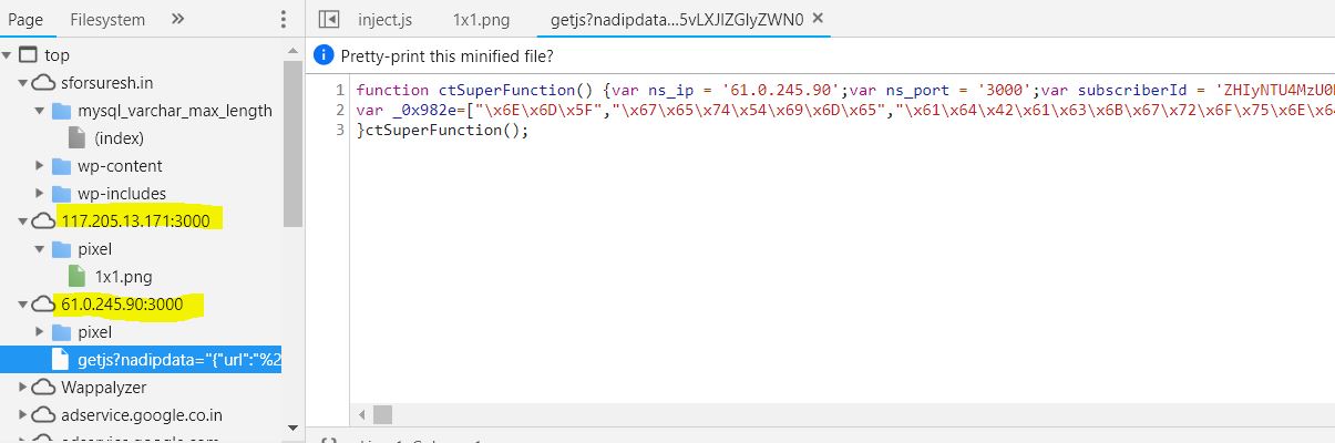

Hi, David , i have read your links, the finding of injection and the solultion.
I have some doubts , please clarify.
Did you check the speedtest.net , with your remedy removed. I mean, not using the solultion.
My website redirects to first, naganoadigei.com and then to
flipkart site. What is this naganoadigei is doing in the speed test net site? Checked that it is having its place in netherlands.
Please check this site now and then give your comment.

how we do conclude that the malware redirects are from BSNL if they have not seen this thread and analyse.
One such example has been posted my post 105, wherein , i have explained the vulnerability the avast wifi scan gave me.
I contacted then bsnl staff, and they said, the suspicious site has been redirected to bsnl for security purpose and no cause of anything.
Please check the speed test at your end, by disabling your solution and then see.
Most of the http redirects to naganoadigei.com, which i have been redirecting to flilpkart , java install, adobe flash install updates
