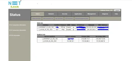

Change VOICE to VOICE_INTERNET.

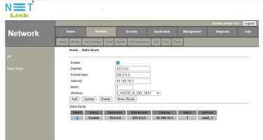

Add a Static Route to the SIP Server. You can add the IP directly like I did in my previous post. But that way you will have to add the return route too which is not there in my previous post. In my case, the return route is 10.x.x.x which is the same with my SIP server so I have to add only one route entry and be done.

This is your VOIP config page. You wil find your SIP Server IP here. The proxy part isn't really necessary.
