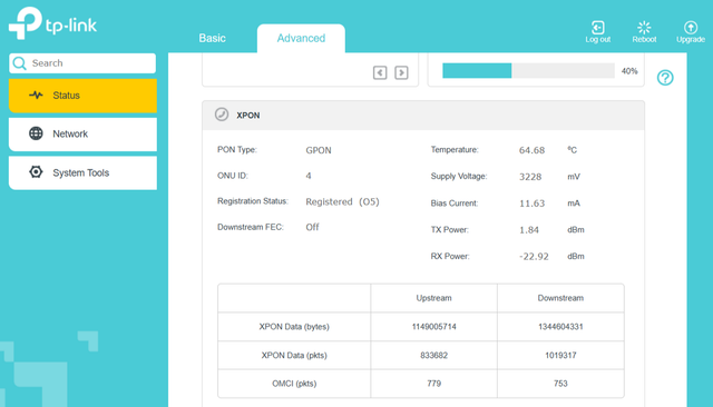

@akshay71 That makes sense. Now that I think about it, I did notice an odd issue with the Huawei as well. When I used the same ONT with the Kerala LCO (BSNL, KV etc), I just needed to create a bridge profile and define the VLAN, I never bound it to a port. However on Airtel, that never worked. I could connect only if I bind the bridge profile with the VLAN to a port and establish PPPoE directly ie VLAN management handled at the ONT. Could be because of this translation issue that you mentioned.
I’ll check if an OMCI client is available on the Huawei and see if I can extract this info.

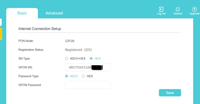

@MrGordon Will the TP-Link XZ000-G7 works with the Asianet Broadband (Direct) by cloning the GPON S/N ? I tried on the Netlink ont it has an option to clone the GPON S/N and I filled the vlan but it didn’t worked
@akshay71 So I got these from the Huawei ONT, not sure how to interpret this. Any ideas?

No luck with 2307 or 2308. Same status as before.
No XPON downstream stats are shown, it remains 0.
