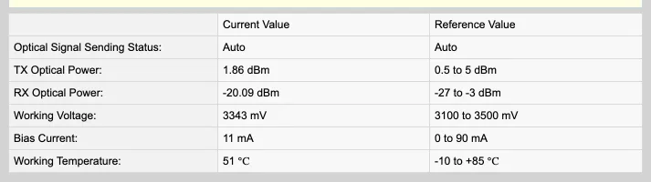

Yep, your input power level is really low and outside the device's optical sensitivity range. Most devices reliably detect optical signal only till -27/-28 dBm and yours is lower than that. You'd need to contact your operator and ask them to bring your power levels higher.
The above is from mine, as you can see the lowest it reliably works with is -27 dBm.

It works for me just fine even at -29 dbm but disconnects intermittently out of the blue during wee hours once in two weeks or so. Issue is neither persistent nor there is a pattern.
Yes, as I said at very low levels outside of the range the device is designed to work, you cannot expect it to work reliably. My guess is that during those time frames there could be other issues leading the signal levels to drop further.

:LOL: I've seen it vary by approx 1 dBm over several days ie -20 dBm to -21 dBm in my case. When your levels are already at the border like @iAnvin, a 1 dBm change would mean it can go to less than -30 dBm, more than enough to cause intermittent issues like he's experiencing.

Amazing! Anyway I talked to my LCO and it took some serious convincing from my side, for him to acknowlege the problem. Initially he was saying it could be some issue with Kerala Vision due to server overcapacity (the usual blah blah blah) and then I send him the screenshots of the power levels. He was curious as of how I was able to get those values and identify that the input signal power is weak, I told him I was familiar with these things (courtesy to Varkey :D )
The guy was so dumbstruck probably because he so far has only dealt with noobs in this area and a customer logging into the configuration page of the ONU was too much for him to process. Finally he said he would fix it within a couple of days.
