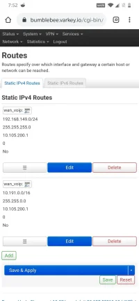

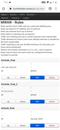

You cannot ping that IP address from the internet interface. It is accessible only from the voice interface.
I have routes configured separately so it works, but the same may not work for you.
