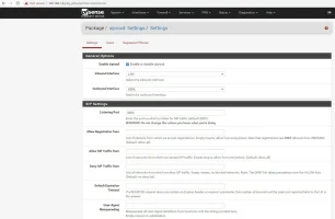

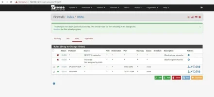

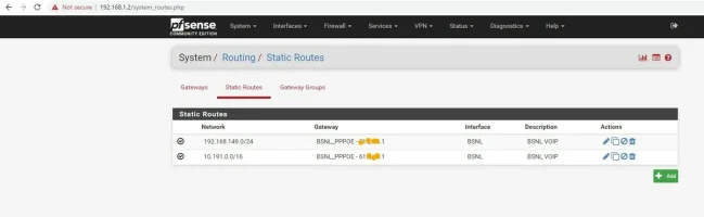

Still not able to get this to work. I am getting SIP registration Failed ( Timeout Error)
Here are my settings:
I connect to BSNL is in Bridge Mode. Port 3 in My Alphion Modem to my Pfsense Box.
SIP Settings:
Username: 914429xxxxxx
Password: tried both "0000' and 'password' - > my PPPoE password
Server: 192.168.149.78
i have setup SIProxd, Rules and the Static Routes. Not Able to get it to work.
