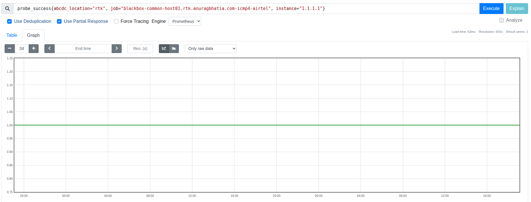

I have over 200k IPs in monitoring from my home and servers including 1.1.1.1. Testing Cloudflare 1.1.1.1 every 30 seconds. No visible losses.

Please share forward trace to 1.1.1.1. It won't give much idea as return path can be pretty wild in case of BSNL and it's hard to know without asking CF for it.
Also, if you have access to a Linux or a Mac, please share output of: dig chaos id.server txt @1.1.1.1 +short
This will give the CF node which you are hitting.
