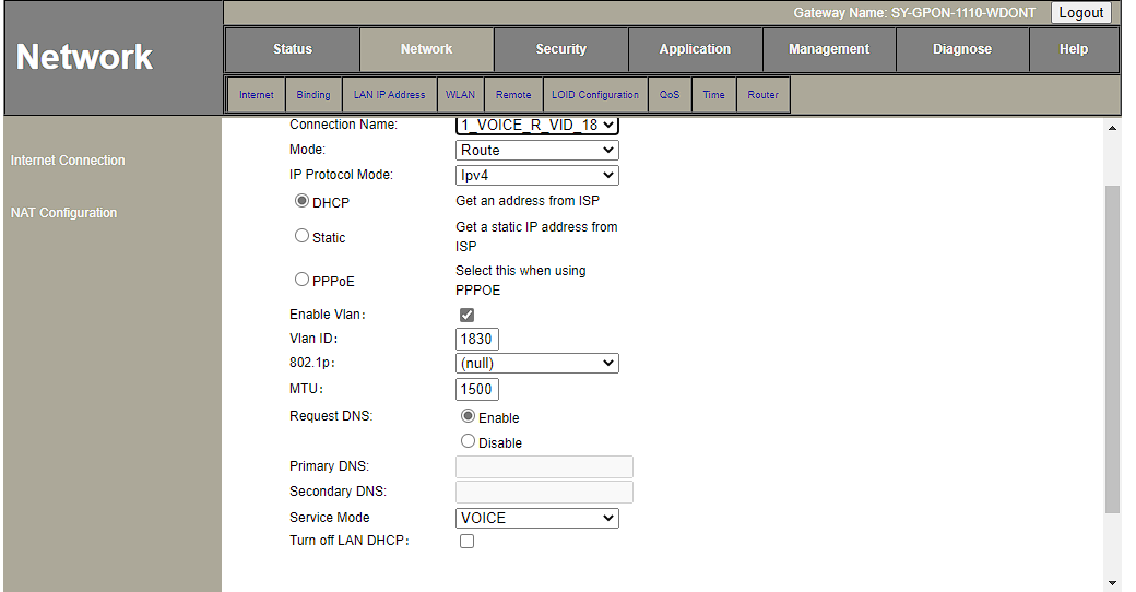

First, create a profile for voice in network tab of ur ont like this.
Upvote 0

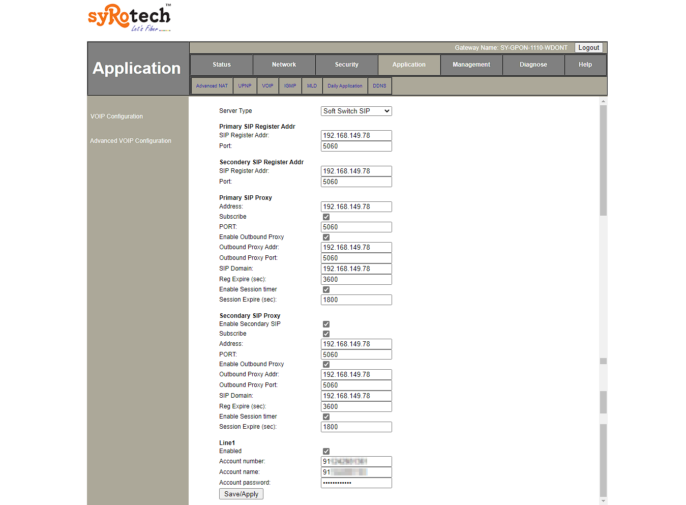

now goto application tab then VoIP and config just like i did
account number should be: 91xxxxxxxxxx ur std code and LL number after 91
account name: same as a/c number
a/c password: same as above.
Now save the config
